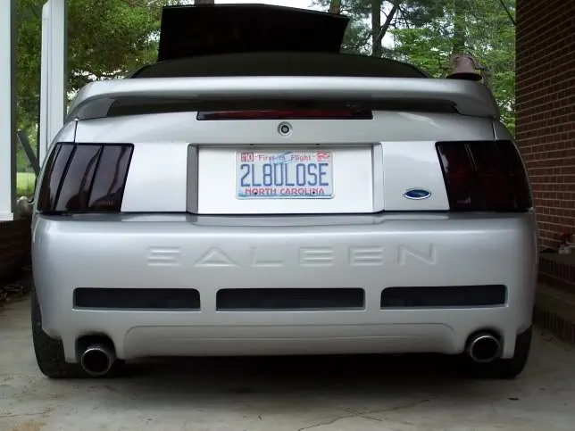

juiced_94gt said:
just color sand the lights wet with 1200-2000 grit wet sandpaper and then buff them with a buffer and they will be just like BRAND NEW!!! trust me im a painter a bodyshop.
Hey, just wanted to thank you for this advice. It's not a 4.6, but the brake light from a 5.0 GT spoiler. Someone had oversprayed badly across it. I couldn't find 1200 so I used 600 grit finishing wet sand paper and hit it with a couple coats of clear; it looks like brand new!
Thanks again.
SaleenGT2001 said:
i like my niteshades spray. if you put it on in LIGHT COATS like the directions tell you to you wont have any problems. also a good clear coat will bring the shine out!!! try the wetsanding and then clear those babys. i think they look good on your car!!:nice:
