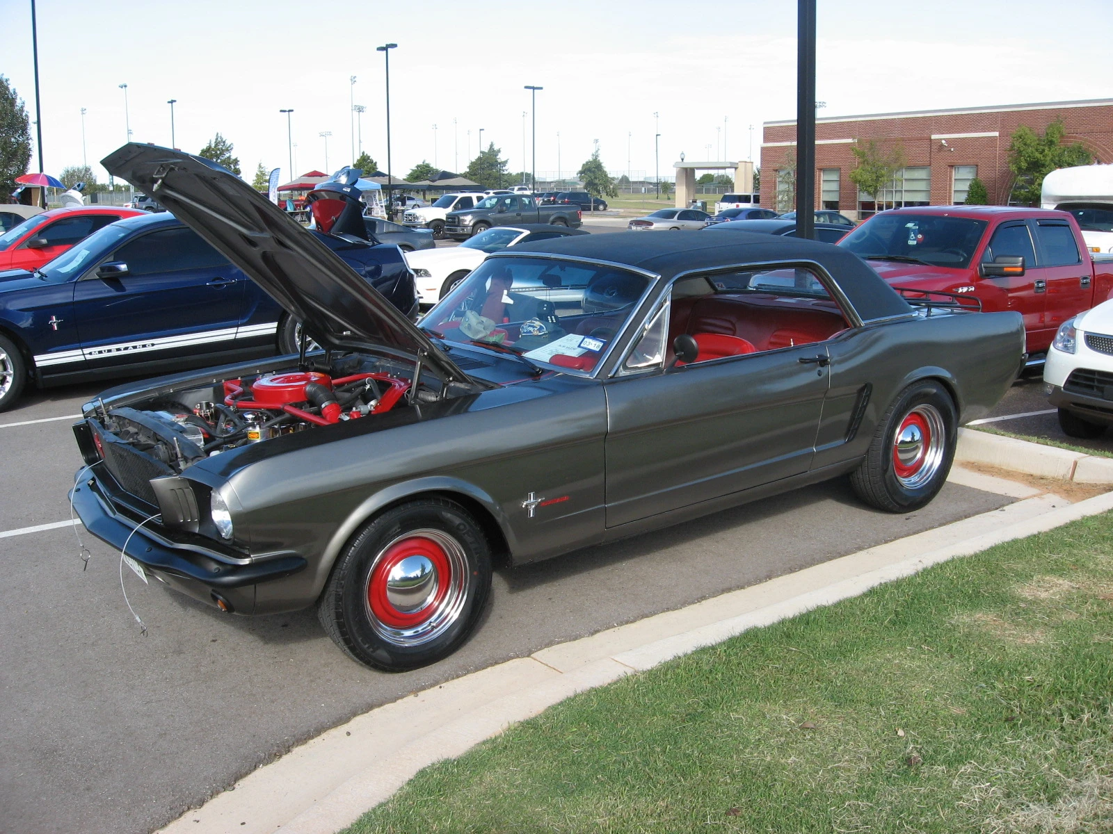

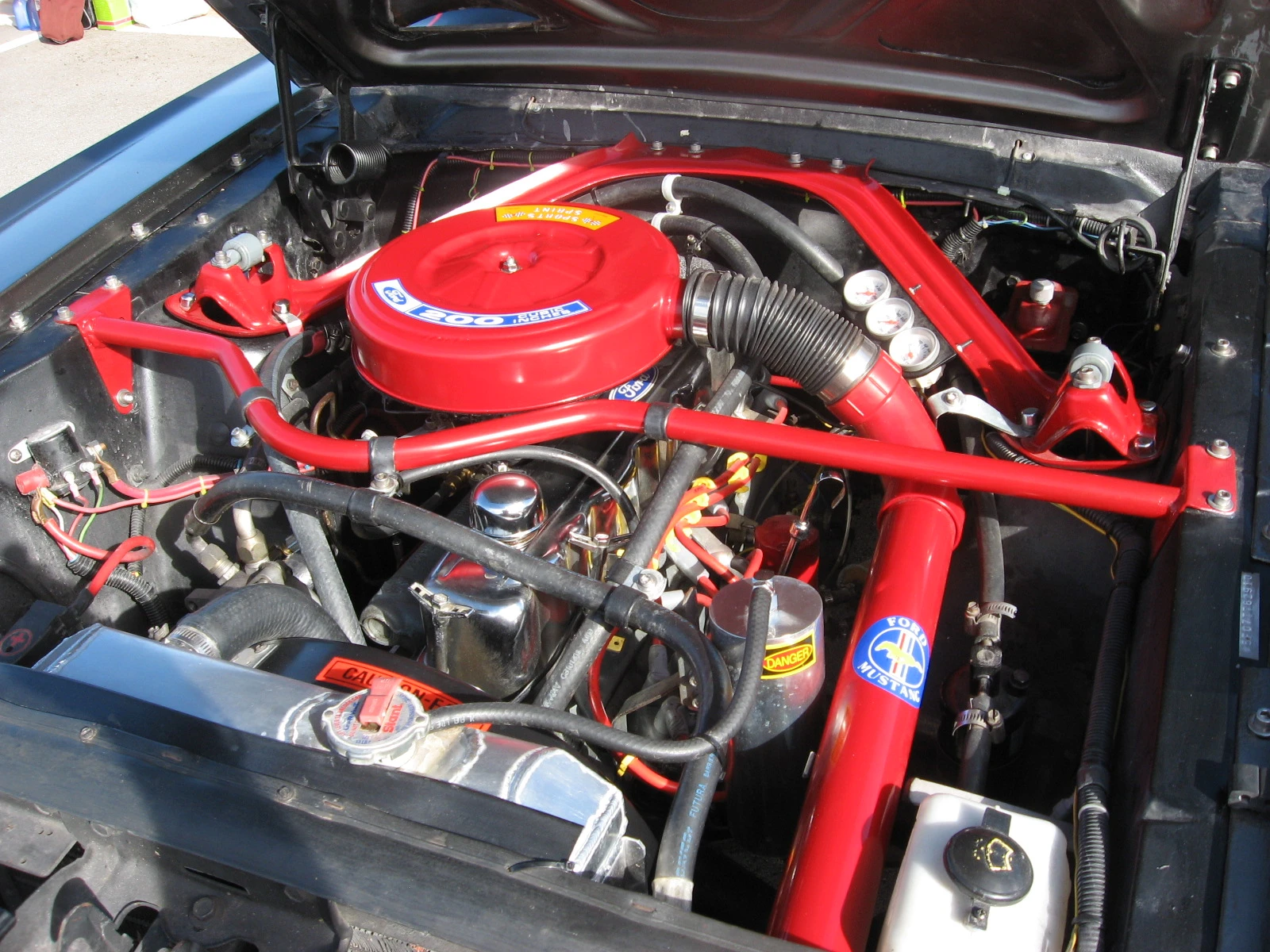

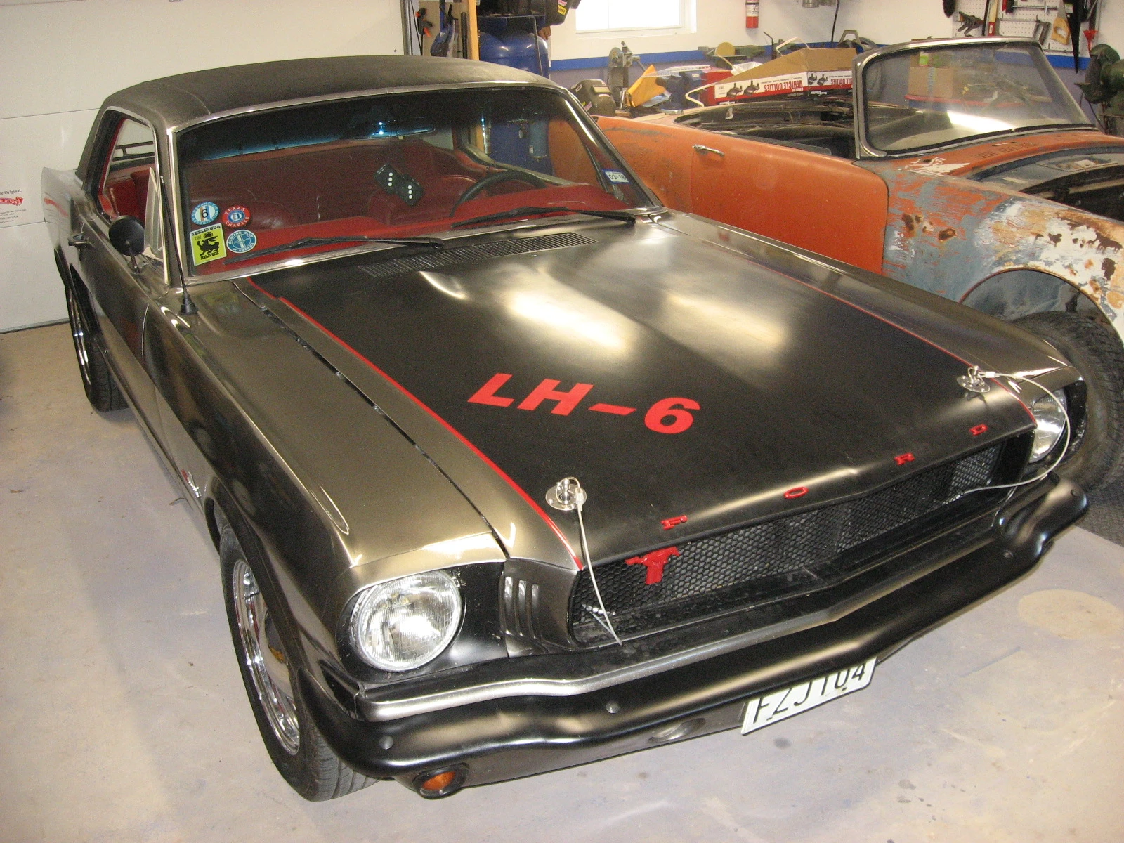

cm409, the kit I used was from Summit I think and about $900.00, but I will check my receipts to be sure. It included all parts needed to convert to power front discs using the OEM 6-cylinder spindles with 4-bolt wheels. I did NOT install the power booster because I am the go-to-guy for the M6A page on facebook, and need to check compatibility with and without power. I am very pleased with the non-power system and I simply never used the booster...but I have it Just-In-Case! It worked fine on my 2,275 mile trip to Tennessee. The 4-lug wheels I use are from an on-line source out of California...15" chrome-reversed with bare centers, I painted. They are 6" wide front and 7" wide rears. The suspension parts are aftermarket POLY bushings except in the front strut. DO NOT use poly there! It is far too stiff and can break the strut when under stress. Use new rubber there. I installed a rear sway-bar with poly bushings and replaced the front bar bushings with poly, but did not go larger on the front bar. I am NOT going racing and I like comfort as well as control. Some argue against this but in turns with poly one feels every bump, dip, rock, imperfection in the turn, while the lighter bar allows some lean before this is felt...yet still helps handling. The 6 lighter weight simply does NOT need a bigger bar! Springs were upgraded to V8 stiffness (85lbs to 115lbs) and I have not replaced the spring-eye bushings, again for comfort. I also have those in poly and will probably replace them later, though poly there could add considerable stiffness. Maybe just on the shackle end...not sure. I had to use 1" lowering blocks after installing the stiff springs. Front springs on the 64.5/65/66 were the same for 6 and V8, so I used later front V8 coils from a 67 GT and cut 3/4 of one turn off. Gas shocks on all 4 corners, a Monte Carlo bar and export brace help force the suspension to work with no fender-flex. Over the years I built for racing and street and most early Mustang cars are drivers like me. Dallas Mustang rebuilt the OEM steering box and with theses changes I love the way it handles. Definitely rebuild the rear brakes when you install the discs. The 6 is a light car, so going with what others do, who own V8's, is often too much for us. With about 25/30 more HP than original, more torque and these improvements, I have shocked several V8 guys with how it corners. Once in the open...they are gone! However, when they stop for gas, I keep cruising.
The brake kit was from Summit, and the kit number is SSB-A120-5. My invoice shows $844.99 + tax of $52.82 and a total shipped to my house $897.81. This was shipped 2 years ago this month. Ball joints, idler arm, and other suspension pieces were ordered in August this year from NPD. A fan shroud is hard to find for the six but I got mine at MustangDepot.com for $79.99. The part number is C3DZ-8146-3. It was called a Performance Fan Shroud for 64 - 66 years. The poly bushings came from Dallas Mustang but are now available form most automotive stores. Good luck with your rebuild.

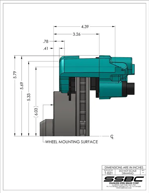

i went direct to the source and called SSBC
i was told to use the fitment diagram they sent (see attached) to determine if my original rims will be compatible with their upgrade kit.
they say the critical measurement is from the center-line of the hub to the top of their
caliper (diagram says 5.79")
if the original rim is less than this you cant use this upgrade because it will rub.
i am still not sure how the depth/backspace will factor in.
the car is in my friends shop who will be helping me with this so at the moment i cant access the rim for measurement.
SSBC says their rotors are 10.25" DIA. and replacement pads can be purchased from any auto parts store.

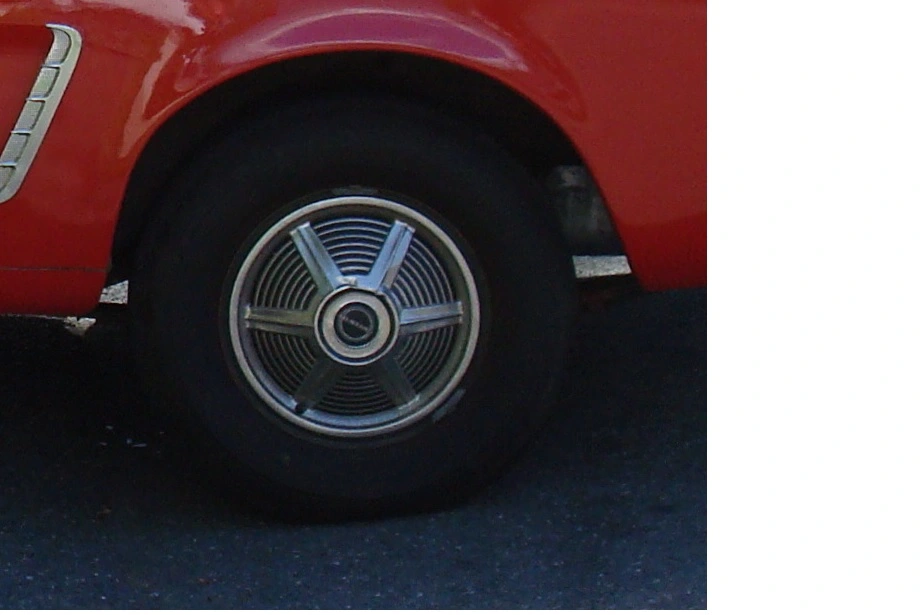

see attached picture of my original wheel and the SSBC diagram
