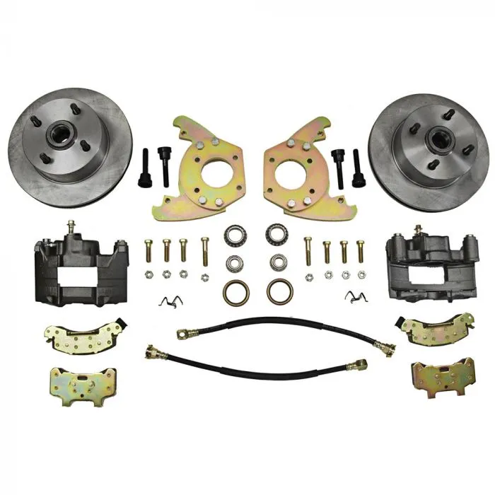

Scott Drake has the 4 lug disk brake kit for 65 inline 6 stang
