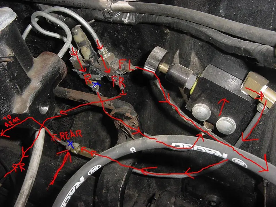

And I will say it once...use an adjustable inline proportioning valve so you can tune your car. They are only like $45-55 and you will not have to change your distribution block or anything else. Also, you will like this...save it, print it out and keep it close. Seems like everyone askes for it eventually!

mfp4073, why do you still run the factory dist. block? Maybe for the brake problem warning light?

As soon as you change to discs up fron on a drum car, the original distribution block/prop valve is worthless. Junkyard a Maverick or Granada piece, or buy from the aftermarket! (Insert another Masterpower plug here!)
