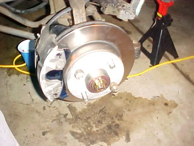

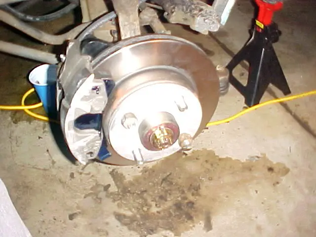

I'm in the process of installing SSBC front disc brake kit for 65-66 I6 Mustangs. I'll have to mod the hard line that goes back to the rear brakes to install the proportioning valve but other than that, rest is pretty much a bolt on.
BTW, the I6 kit is a single piston sliding cliper type whereas the v8 version is the 4 piston fixed type.
