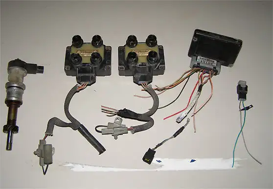

EDIS is pretty simple for fox mustangs. I salvaged an EDIS module from a 94 Crown Victoria, distributor stub ( cam sensor ) from a 1997 5.0 Explorer, and coil packs from same vehicle.

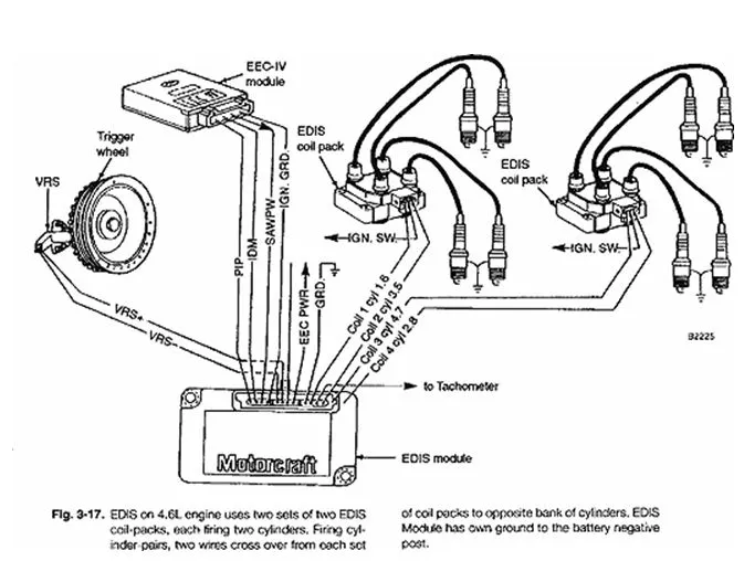

With a MSPNP2 but it can be done with the stock computer. The EDIS8 module times the spark by reading the cam sensor in the distributor hole. Not real complicated. This is what's needed- minus trigger wheel and crank sensor
Here's the wiring diagram
Reactions: Mustang5L5
Just did some reading up on this. Seems pretty straightforward. Might have to add this is a project down the road when I finally step up to a aftermarket ECU (or just want to tinker with the A9L)

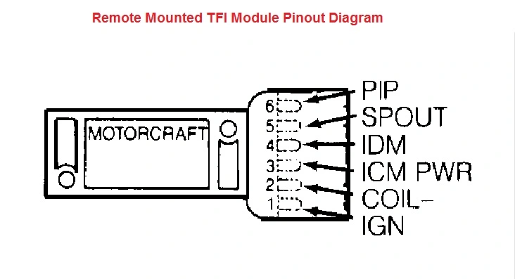

TFI SPOUT to EDIS SAW (pin 3)
TFI PIP to EDIS PIP (pin 1)
TFI Ground to Ground (pin 7 or 10 or both)
TFI Ignition On to EDIS Ignition On (pin 6)
TFI yellow/tan tach signal to EDIS pin 2
Coils A-B-C-D --> EDIS Pins 8,9,11,12
Crank Sensor --> EDIS Pins 4,5, and shield goes to 7.

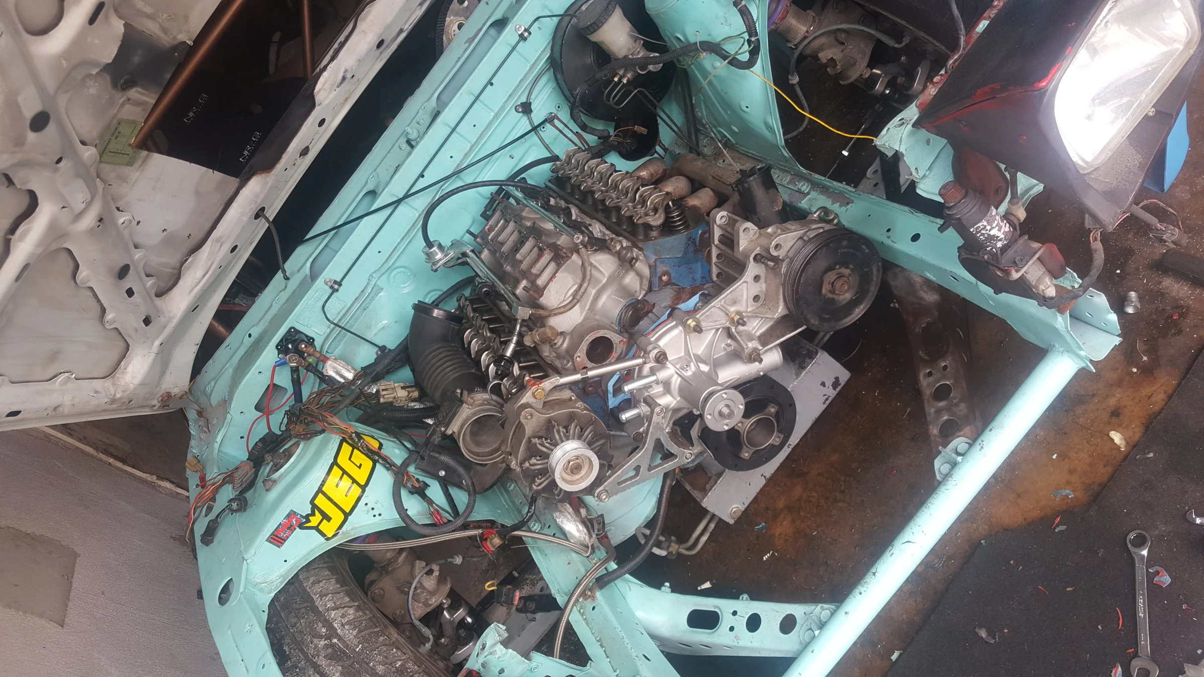

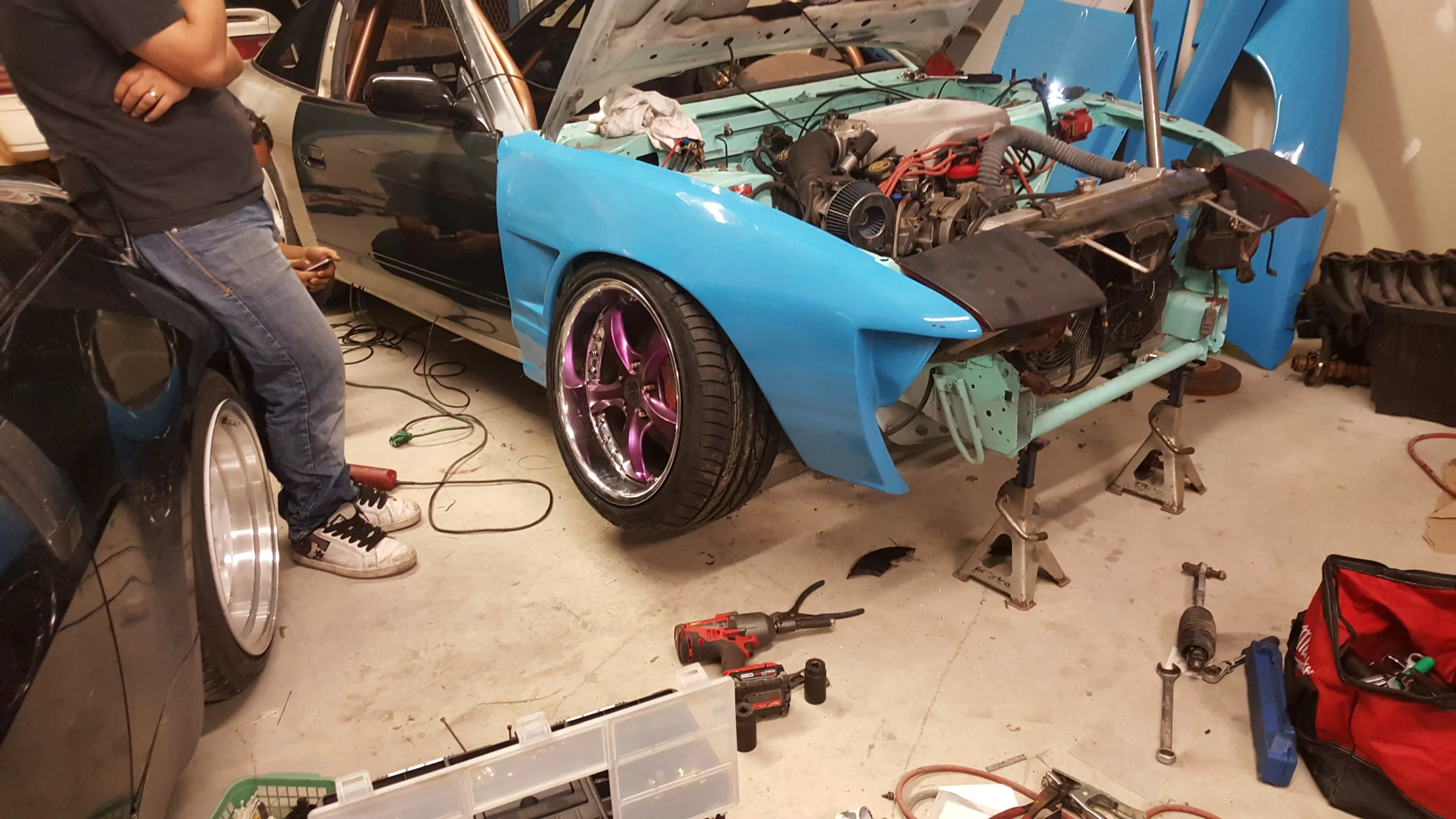

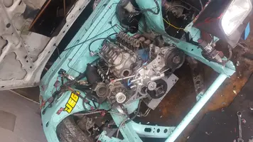

Yes, i have ms3 pro. Using LS coils, with a trigger wheel, wanting to find out if a CPS from an newer 5.0 with drop in as a replacement for distributor for oil pump and cam senser. Just seeing what my options are, engine is out getting ready for a rebuild.
P.S probably not the typical car on here but the 302 is in a 240sx drift car.
