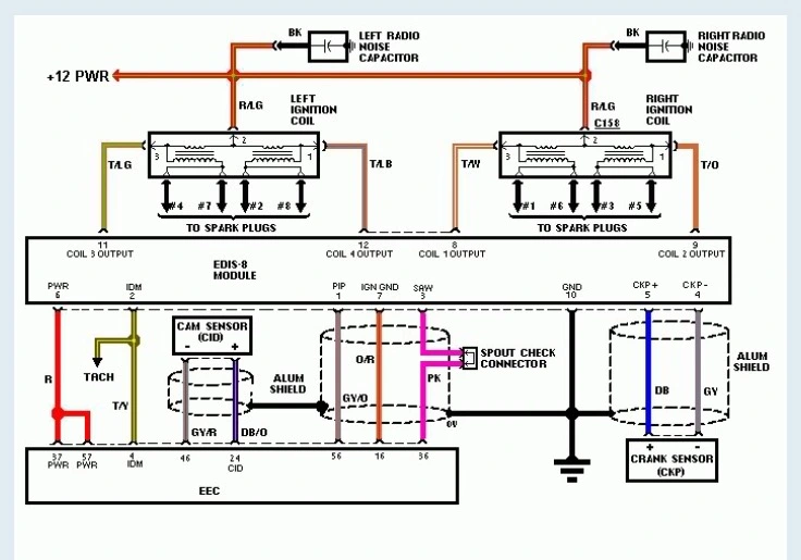

With an A9L, the Explorer cam sensor does get wired into pin 24. It's used to time the injectors pulses. But, unless you go into the programming and change a few scalars to activate the EDIS and have it look for the cam sensor input, you will forever be locked at 10* of timing with no computer advance.

This pertains to wiring with the A9L.
Explorer cam sensor wires to pin 24. There are two different cam sensors, 2-wire and 1999-later got a 3-wire. 3-wire is Hall effect and 2-wire is VR like the crank sensor. Unsure which is most ideal for this scenario. MS doesn't need cam sensor

Since you need a tweecer or moates QH to modify, I can't proceed. My parts are in a box along with these wiring diagrams and down the road, If I do an MS, I'll revisit.
