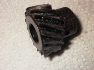

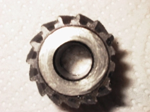

Do you see the files attached on pervious message ?
What do you think about strippe ? Only one side is stripped ! :scratch:

I do see the attached pictures. It is hard to tell, but are you sure it is a steel gear and not a cast iron gear? The way just a few of the teeth appear to have "snapped" off while the rest of the gear seems Ok bothers me. Especially since you say the cam gear appears to be fine. Double check that the gear is steel and not cast iron. The FMS part # you referenced is for a steel gear for roller cam, but I would think there would be some good damage to the cam gear to produce snapped off teeth like that.
