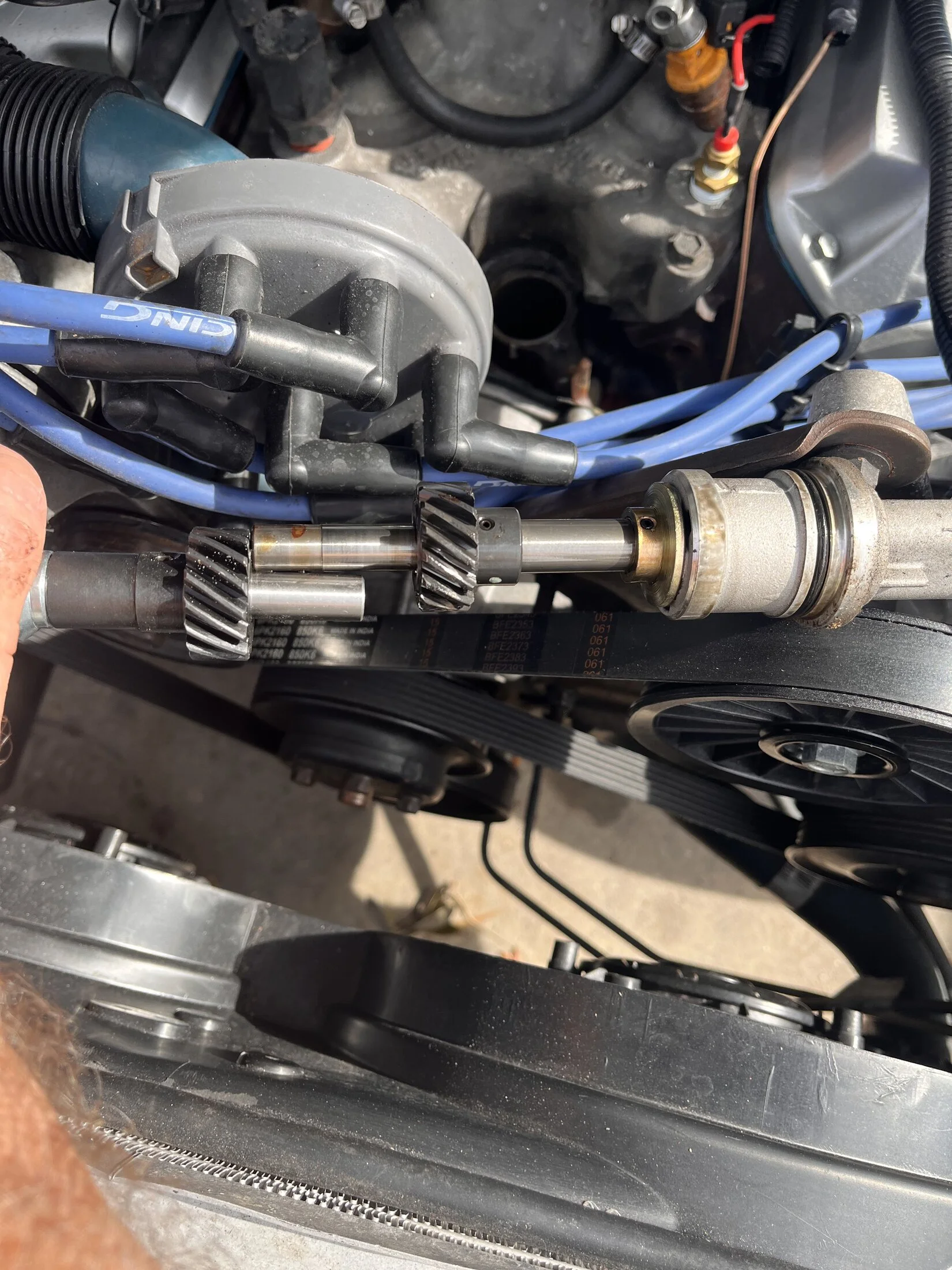

I'm about to start my carb swap on my 89 LX. So I have gathered, or thought so, all of my components to do a swap however after reviewing a recent YouTube video, the guy mentioned the proper "long shaft" distributor. So is this a reference to the aluminum shaft housing or the portion that extends below the gear? My steel gear distributor for a 85 manual car and it has a short shaft beyond the gear. Reference pictures online give mixed results. Can a short shaft be used?
I’m not sure I understand your question. A carb swap doesnt require a distributor change. Please explain further and post pics if you can, to illustrate what you’re trying to accomplish. Good luck.
That would probably help. Old on right. After getting some light into the distributor hole and measuring, it would appear the the engagement onto the oil pump shaft would be 1/2" instead of a full 1".

Can you get your hands on an 85 Mustang distributor? It's already setup for a roller block.
That's what I bought however the shaft that extends beyond the gear is about a1/2" shorter that the EFI distributer. It will only engage the oil pump shaft approximately a half inch however I'm beginning to wonder if that's the same on the 85 block also and in that's case I'm good to go.

I believe you can swap the distributor shaft from the EFI distributor over the the non-EFI distributor. Its a bit of work but the 85 GT distributors are hard to come by.
AS in a carbed EFI distributor? That would be a one year only unicorn wouldn't it....
Yes. From my understanding the parts store distributors you get for an 85 are all over the place but the body is correct. If you have an EFI distributor you can remove the shaft from it and put it in the parts store 85 unit and have the longer shaft.
Another thing I came across is that the longer shaft in the roller motors was to ease the installation of them on the assembly line. The longer distributor shaft engages the oil pump drive before the distributor gear contacts the cam gear so it makes it easier to install. From that I took it that there is no other benefit.
