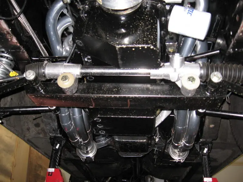

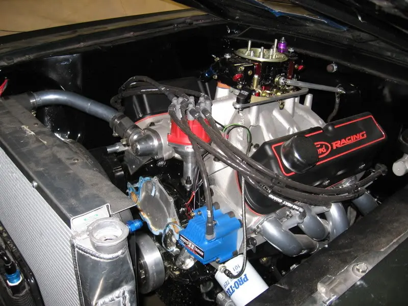

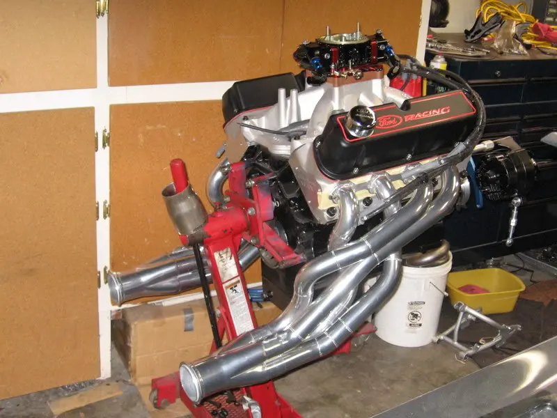

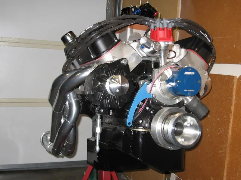

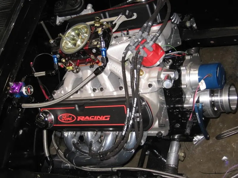

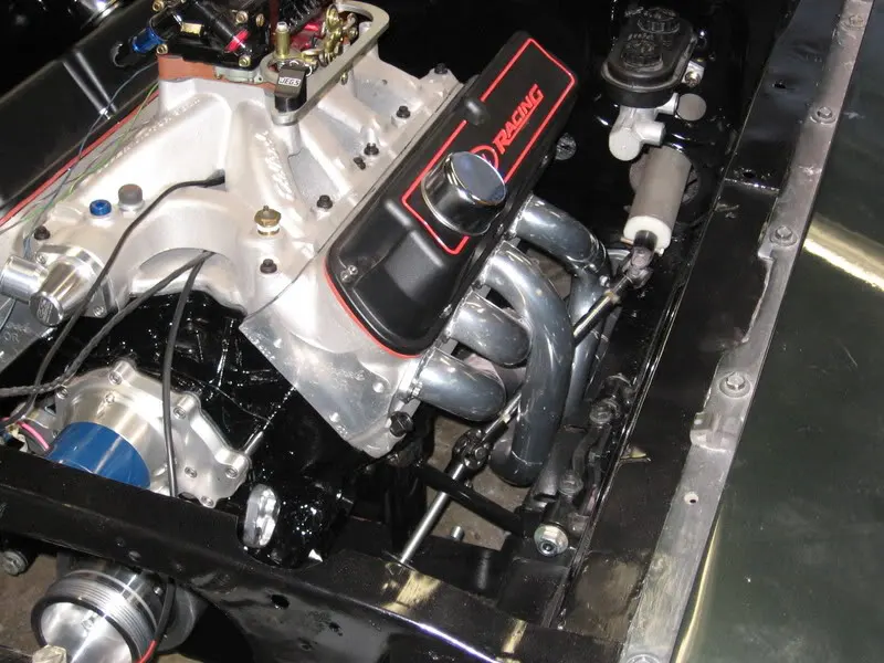

I made my own headers for my 65 mustang. All I can say is be patient it takes a lot of time to make them right. I had no choice but to make my own headers because of the engine i was using and the size of the tube. I made 2 inch primary tubes to a 4 inch collector. Here are some of the picks from the finished headers good luck if you have any questions let me know i have built a few sets
