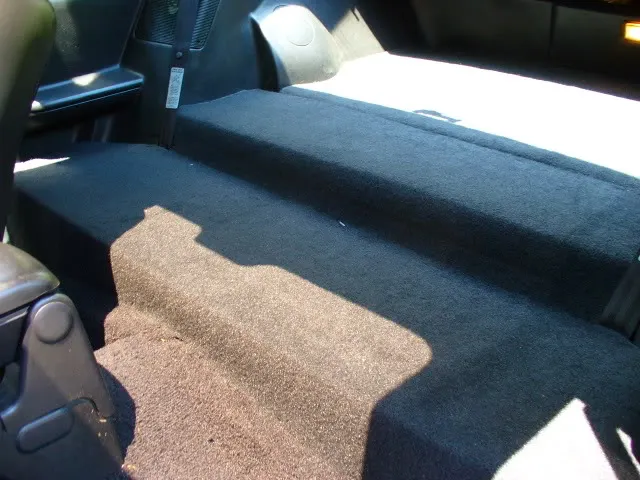

i just took my backseats out. cut carpet and used spray glueto help mold it to the floor. it look like the 93 cobra r

lex2lo said:
nice job bullit looks clean!! id like to do the same what did u use?
Make note that his car is a 95, you can't do it the same way on a foxbody hatch.

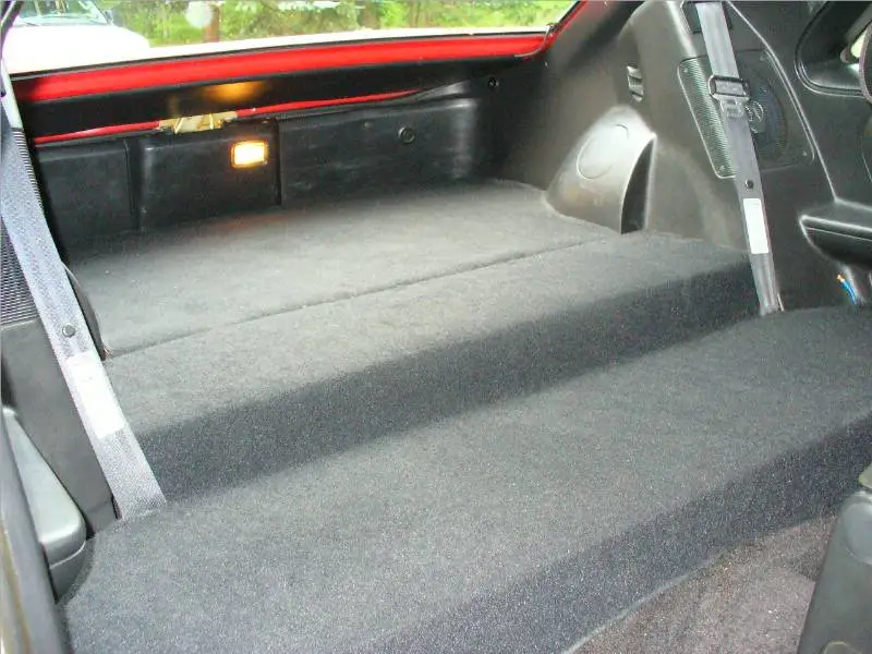

I like the one that I did a couple years ago...intended to do more to make it look more natural...but i sold the car...

should have removed the seatbelts, they look funny hanging there.
You also did an A+ job on that and your car is very clean, Mint i would say.
Thats how a seat delete should look I think, but I will agree with him on the seatbelts, but other than that looks really good
