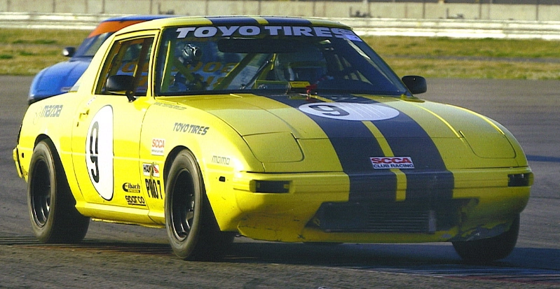

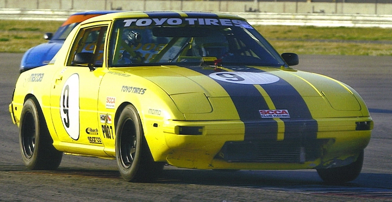

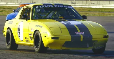

The minimum weight for the class I race in is 2300 lbs. We have to run 13" wheels, and with 205/60R13 Toyo Proxes RA-1 tires the thing will corner like you wouldn't believe. These aren't exactly practical tires for the street, but you get the idea.
