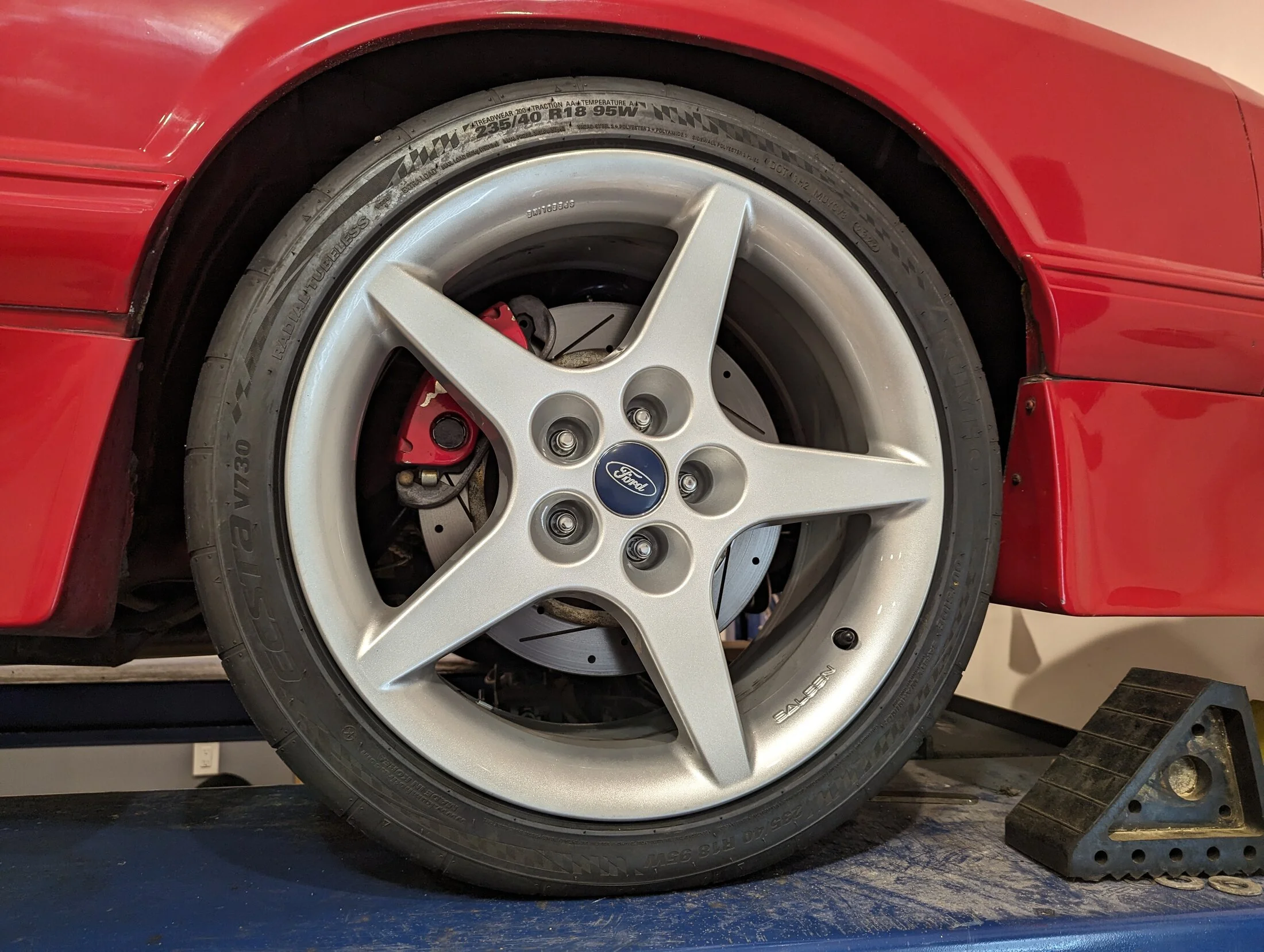

Had my front wheels refurbed and new tires. Kuhmo V730 road race style tires. Now i have to put fender liners back in because these throw a lot of sand like drag radials.
Oddly a place by my house redoes the wheels and mounts and balances tires for $155 per wheel, i figured what they hell, some places charge $40 a tire just to do the tires. I switched the saleen center caps to ford ones, not sure how i feel, i may try a set of speedline center caps (these are speedline wheels). Added gorilla lug nuts, forgot what they are, but they are very small and unassuming. Key only. Tires are a 235/40/18. I lowered it about a 1/4 of an inch after this pic was taken.
I measured the fenders before and after the ride, the car did NOT drop at all. That's with quite a few new parts. So i think it's safe to get an alignment since it's way out of wack. It's surely higher than before because the X pipe no longer hits the cross bar on my lift necessitating wood planks on the ramps.

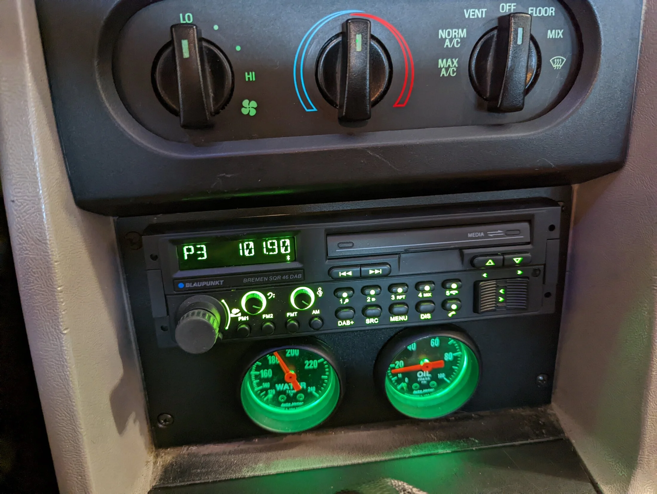

My blaupunkt retro stereo is awesome, but i shut the battery off my car each time i park it. I've done this for the last 20 years. Not the end of the world to reprogram some stereos, but this one you need a degree for, i can't spend 10 minutes programming the stereo every time i drive the car. I don't know the solution here, other than put a whip out somewhere (in the back where the battery is) for a tender. My opinion is killing power to the car makes the battery last forever. My last battery went from like 07 to 2021. I just wish i could give the stereo a back up power, but my guess is that if i do, it will back feed the entire system draining the back up battery.
Is there a solution for this?
Also removed the gauges from my vents and install a smaller set below the stereo.
Note: Behind the tape deck door is usb and card slots.

There is very little draw on the memory wire of the radio. I think it is in the range of 0.007 amps (measured it once long ago chasing a draw that turned out to be the alarm) so leaving that connected to the battery side of the kill switch should not affect the batteries long term.
Good point. I may have been over thinking this. I may just have to run a wire to the back of the car.
I was kinda thinking of a 12v rechargeable battery on the constant hot line to the radio with a diode blocking power from going back to the vehicle.
With my car, i just connect a trickle charger up maybe every 4-6 weeks for a few hours to top the battery off. When it's fully charged the trickle charger displays a green light. I then remove the trickle charger rather than leave it hooked up.
I did that for years without issue. Bought the battery in '09. During the summer i'd go for a short drive every weekend so wasn't an issue. In the winter is when i would use the trickle charger every few weeks.
I disconnected my visor lights and took the hood light bulb out. I found those were always the source of accidental drain for me.
Reactions: limp
I'd guess for sure it's the mirror lights for me. is there a connector on them? I haven't looked.
There is.
Unscrew the two screws and drop the mirror down and you'll see the wire. Keep gently pulling out and you'll find the connector. I disconnected it and then tied a small string aroung the connector and fed it back in. I then tied the other end of the string to the disconnected side of the mirror. That way if i ever wanted to reconnect them (not likely) i could just pull the wire back out.
In 10+ years...i haven't reconnected them. I don;t need to look pretty.
Reactions: 2000xp8
There is.
Thanks, i'll disconnect them.
It's tough for me, i just feel like everything should work, yet i've had those flaps rubber banded closed for 20 years because they do work, lol.
My map light also didn't come on. My son asked me what it was, when i went to show him, it didn't work. I used to have to just flick the little switch that turns it on when it's released from the holder. I'll have to mess with it, i see that make a repro, but it's not really where i want to throw $100, my guess is that it's an easy fix internally.
Sometimes fixing the map light can be as simple as tightening the screws being that one of them provides the ground to complete the circuit. Give that a try then check the bulb of course. Should be an easy and quick fix.
I agree with the mentality that of its there, it should work.
But those lights are more trouble than it’s worth when it comes to battery drain. Best to just pick your battles and they aren’t worth it.
Why not just put a tender on it?

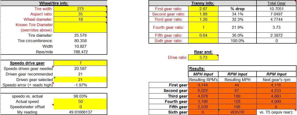

Gimme your rear gear ratio, rear tire size, & what drive gear or year of your transmission. Wanna crank some numbers out. Think you might just need a speedo needle tweak.
Also, I know how cars can sit, and getting a car I didn't take too seriously, Black Jack, seems to have snapped me out of my own funk. Now, I have done a lot with it & have plans for all 3, this year.
Honestly I like the simplicity of getting out, waking around the car, shutting off the battery switch mounted in the rear plate and going in the house.
My battery is in a moroso sealed box in the hatch, the tender is just another step i don't want to do. Maybe for the winter. I have a few of them, i just don't seem to use them unless needed.
I'm going to give Mike's suggestion a try. Lose the power to the visors. I have a 1.5 cowl hood, so there is no light under the hood.
Honestly, it's been so long since i didn't shut it off that i don't know what it will do.
If that doesn't fly, i'll add a wire directly to the battery as aero suggested.
3.73
275/35/18
TKO600 https://www.tremec.com/menu.php?m=103
.68 5th
Red 21 tooth speedo gear.
Not sure what internal is in a TKO600
I could have sworn i needed a white gear and i think that is what i took out.

Battery also in a sealed box in the rear but have the battery tender pigtail wired up in the engine bay for easy access. When I need to charge just open the hood and plug it in.
Yep. That!
@2000xp8 It's a 7-tooth, based on quick research. Will plug it in my calculator and update this before bed.
I dunno, the hatch opens with a button or a key and if you don't close it right, it will never fly open. I don't like either option, but opening the hatch seems to be easier and safer, lol.
Hatch works, too. If you want a solution to a battery drain for a car sitting... well, it's two options, shut off the battery somehow, or plug in a tender. Your call. I've actually heard of devices that will auto cut a battery after sitting for a prolonged period of time. Never used one.
Anyways, here's the math on your setup:
21 is the right driven gear for your speedo cable. At 50 actual, your speedo should show 49 mph. The fact that it's off by 5 suggests that you should pull the speedo needle out and reposition it correctly. Note: the needle does NOT point at 0 when there is no signal if you remove the needle 0 stop bar. It should point at a white dot below zero that's readily visible when you remove the gauge cluster. I didn't catch whether it was reading 55mph at 50 actual or showing 45 at 50 actual.
The mph outputs in orange assume the stock 6,250 RPM limiter. So, at the limiter, you'd see 44mph in 1st, 67mph in 2nd, etc...
All of this assumes my quick research on the 7-tooth gear in the TKO-600 is correct, and that the tires are accurately sized according to the width, aspect ratio, and wheel diameter... they aren't always exactly perfect, but should be close enough.
