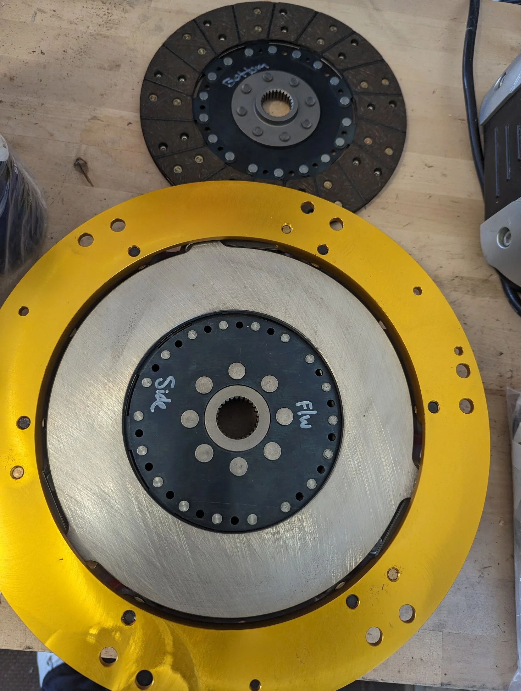

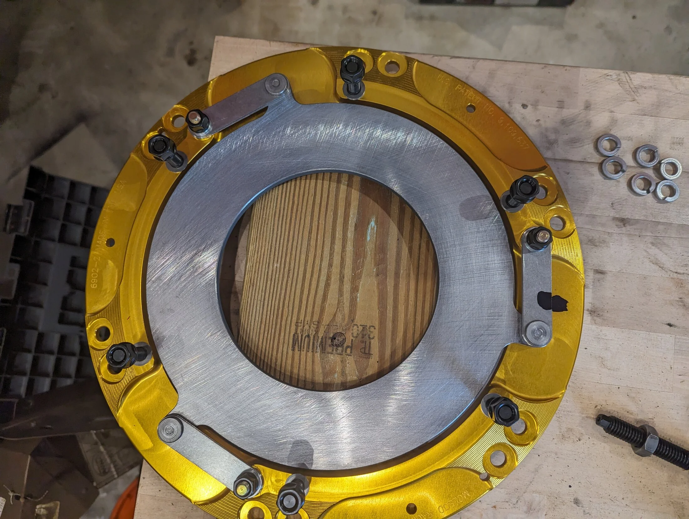

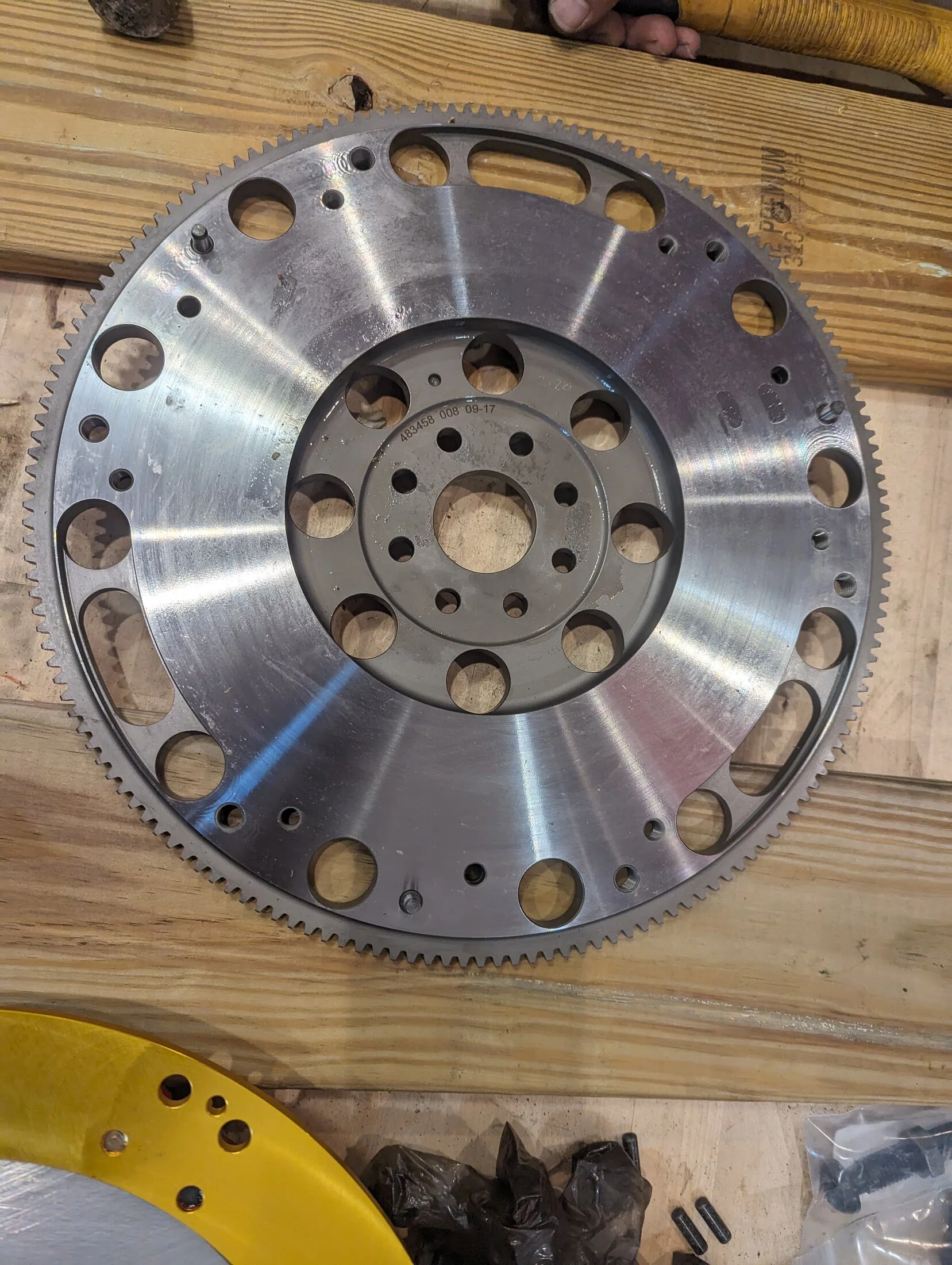

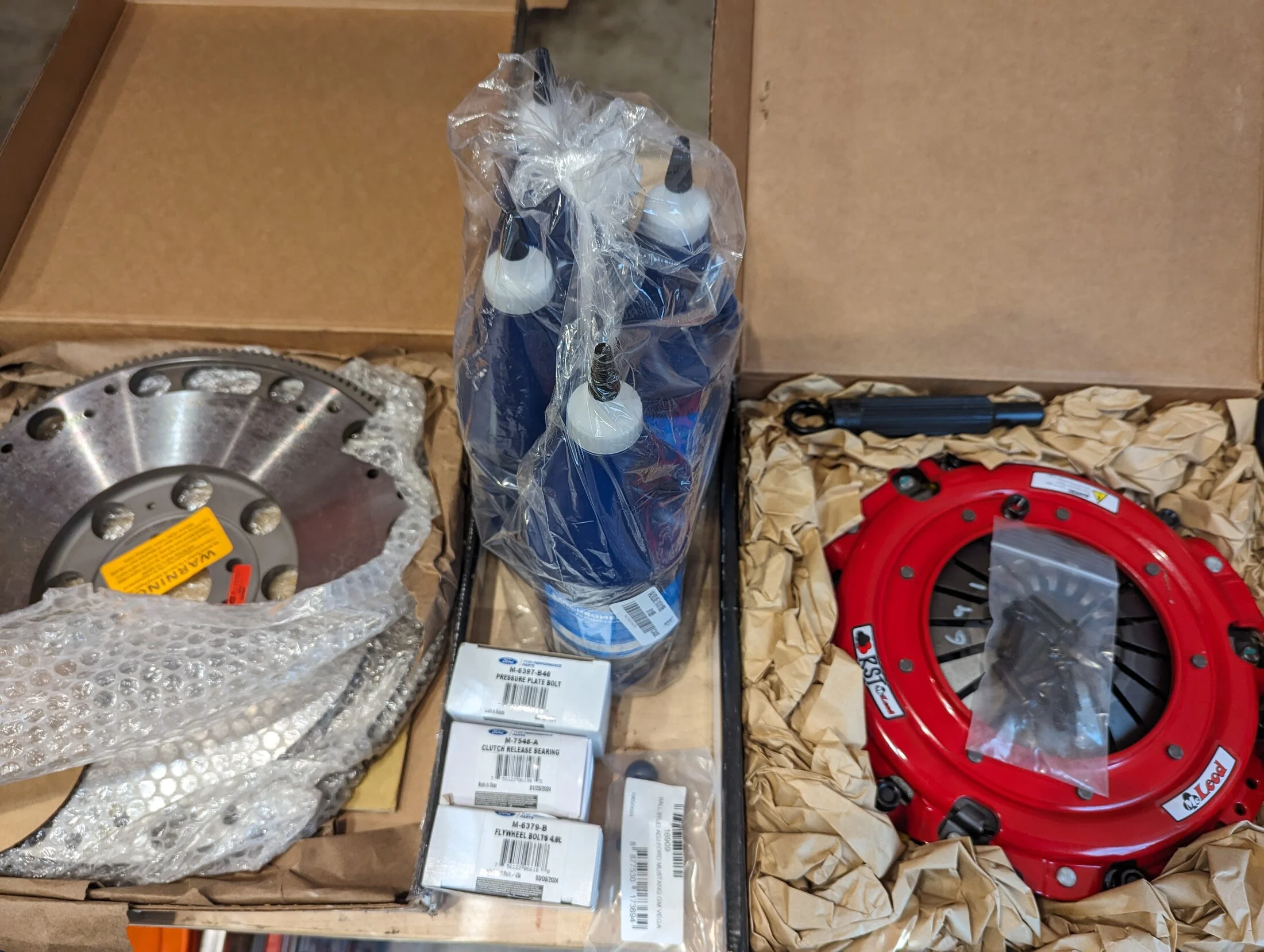

Picked up a lightened steel flywheel from mcleod, it's about half way between the solid steel weight and the aluminum. I got it ebay from AMP racing for $300, which is about $100 savings. Drilled for for both 10.5 and 11.
Saw the mcleod twin disc at CJ pony parts at $80 off, really never have seen on sale much past that if at all.
Bought all new bolts and throwout bearing. Picked up valvoline synchromesh, the penzoil was out of stock everywhere i looked and the GM stuff is seriously expensive. Supposedly it's the same.
Also purchased and adjustable pivot ball, which was $50, my friend who worked at my other friends race shop suggested it. At this point not sure the 50 bucks really mattered because even with $200 off and some other 6% discounts, this is still like a $1200 clutch.
Most likely install it Sunday.
Unless something goes wrong, should be a quick install. (keep in mind i have highly qualified help and a 4 post lift).
Hoping it's all the great things i've heard about this setup.

I guess this is how they ship them, same as last one I returned.
Its the part number on the fingers, they all seem that way.
I also get the feeling the clutches are all the same size and they just use different adapter plates.

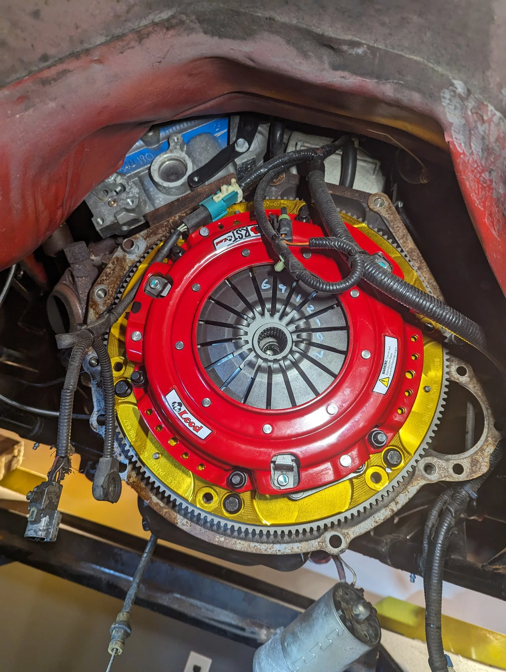

So we installed the clutch yesterday. Relatively uneventful.
Though i never took into consideration that last year i installed a torque arm.
Makes getting the driveshaft bolts out more of a pain.
The way i handled the driveshaft itself was to the bolts out, raise the car by the frame (with a hydraulic slide jack) letting the rear fall and sliding the driveshaft back over the top of the rear. Couple extra minutes, but i'd rather that than remove the torque arm.
I'm going to guess my old billet flywheel (which shows no wear) is 3 or 4 pounds heavier.
The machined adapter is also a bit of a work of art.

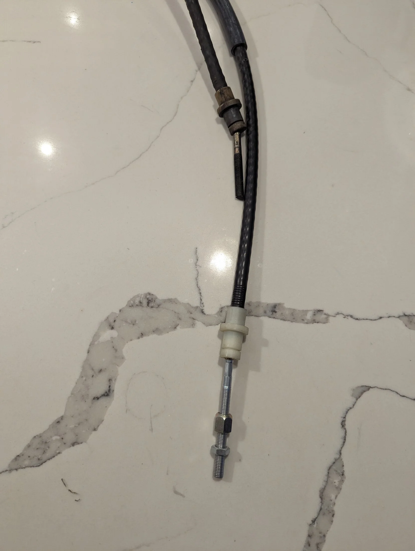

Now in all fairness my cable is a 20 year old adjustable that i never really liked. Though when disconnected from the fork it does move freely. But with the load of the pressure plate on it, i can see how if it's all dried out the friction could bind it.
It was suggested I buy the good steeda cable.
Not sure or not if i could use the 96-04 which i think is longer so the routing could be a little more straight on.
I may buy one for a 90 and one for a new edge and see how they fit.
The cable has to be adjustable because the firewall adjuster really has no room because it's right up on the valve cover. PXL_20240324_160142298.jpg PXL_20240324_154031023.jpg PXL_20240324_152620509.jpg

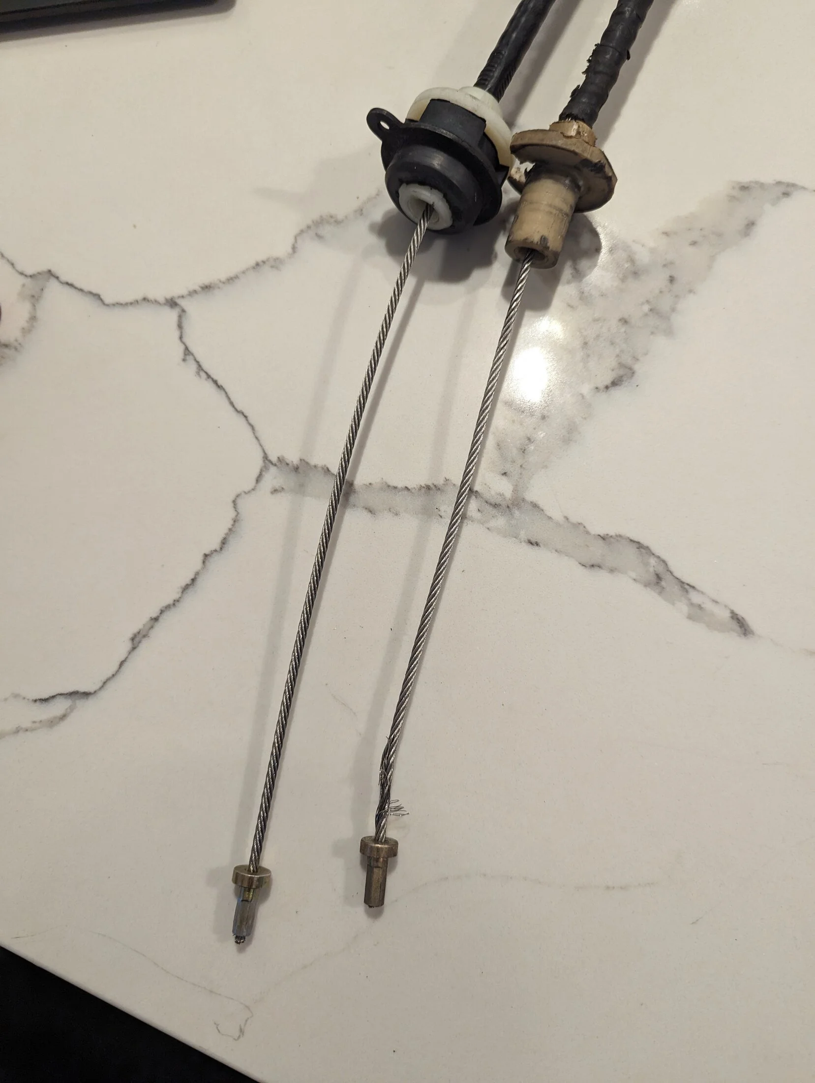

Ordered the new cable and a double hook quadrant. I went with the 4.6 version which i'm guessing is just longer for routing around the engine with the heads being so wide.
The MM cable which is apparently the top cable is good for 83-04. I can't use that one because it's not adjustable and as i said the firewall is really close to the valve cover. So my guess is that from the bell to the fork and the firewall to the quadrant all the measurements are the same from fox to new edge.

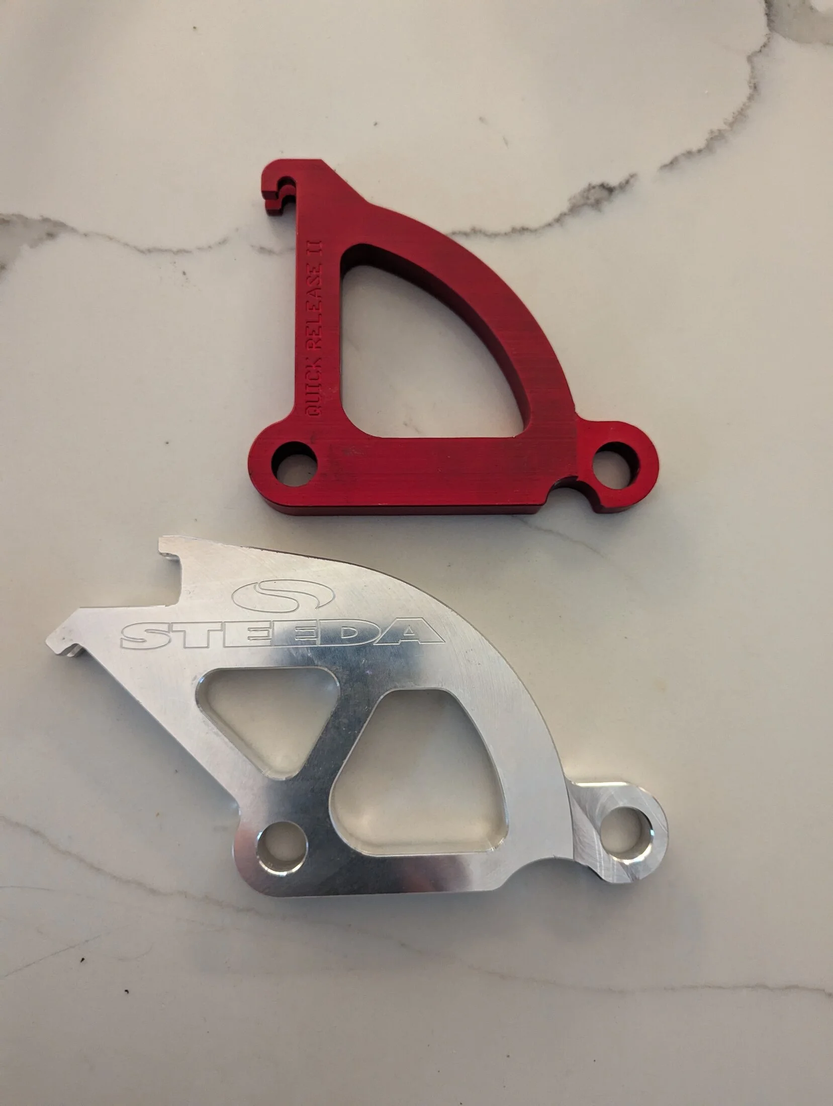

So i swapped out the quadrant and cable.
Removed the firewall adjuster.
The cables are the same from a foxbody to a new edge, but it's about 8 inches longer.
Had to cut the bottom half of the white grommet off to get the cable out of the firewall. that's how tight the valve cover to the firewall is.
I didn't install any firewall adjuster, so i used the longer distance hook. There is no point in one because of the value cover clearance issue.
Still had to learn some lessons again.
First off, why i don't default to removing the seat i'm not sure.
Second, why did i spend 3 minutes looking for the quadrant (that I installed) all the way to the left? I realize the pedal is there, but for some reason i forgot it was towards the passenger side.

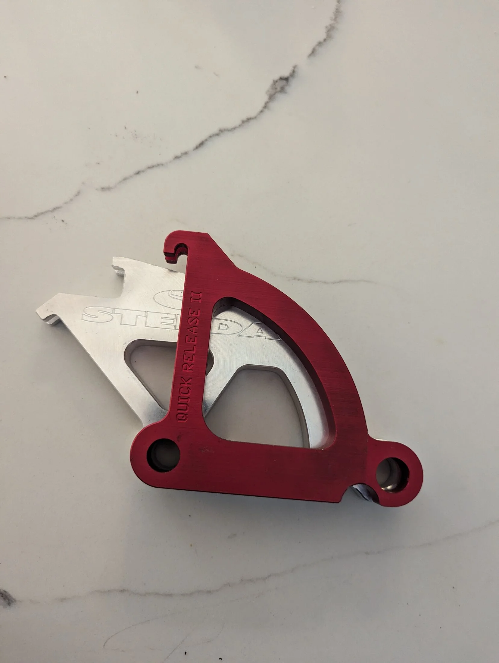

You can see in the pic the difference in the quadrant. I'd say the steeda version has a mechanical advantage with the curve being longer. Also the red one fraid the cable where it hooks. And it had no spacer bushing like the one that comes with the steeda.
The new cable moves much more freely.
Though now i have an issue on where to bolt it in because the bracket really doesn't line up with anywhere on the frame.
If i don't figure it out, i'll buy a fox cable again.
Took at least 5 routing methods to get it to where it is.
One thing to note about a modular swap, there just is no room for anything at head height. So the cable has to go in front of the alternator (which makes it too short) or towards the firewall which makes it a little too long.

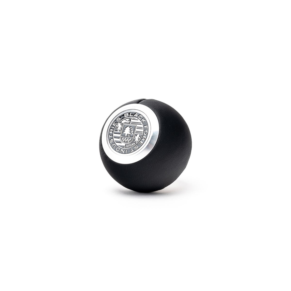

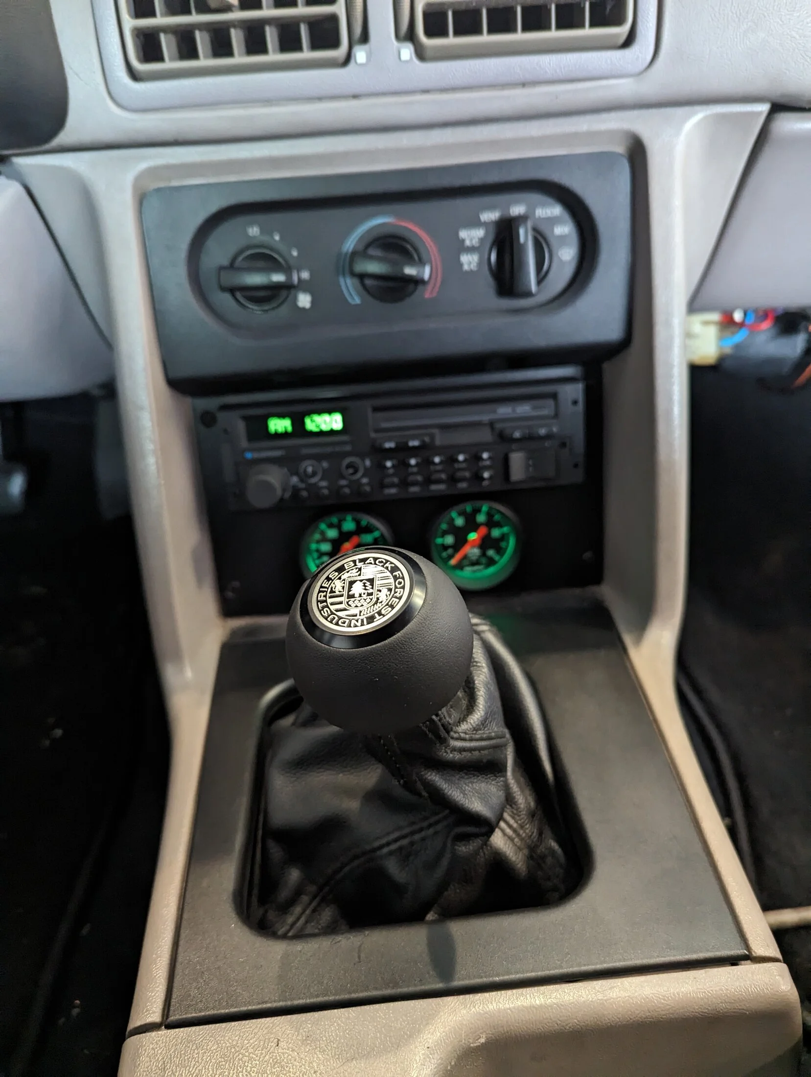

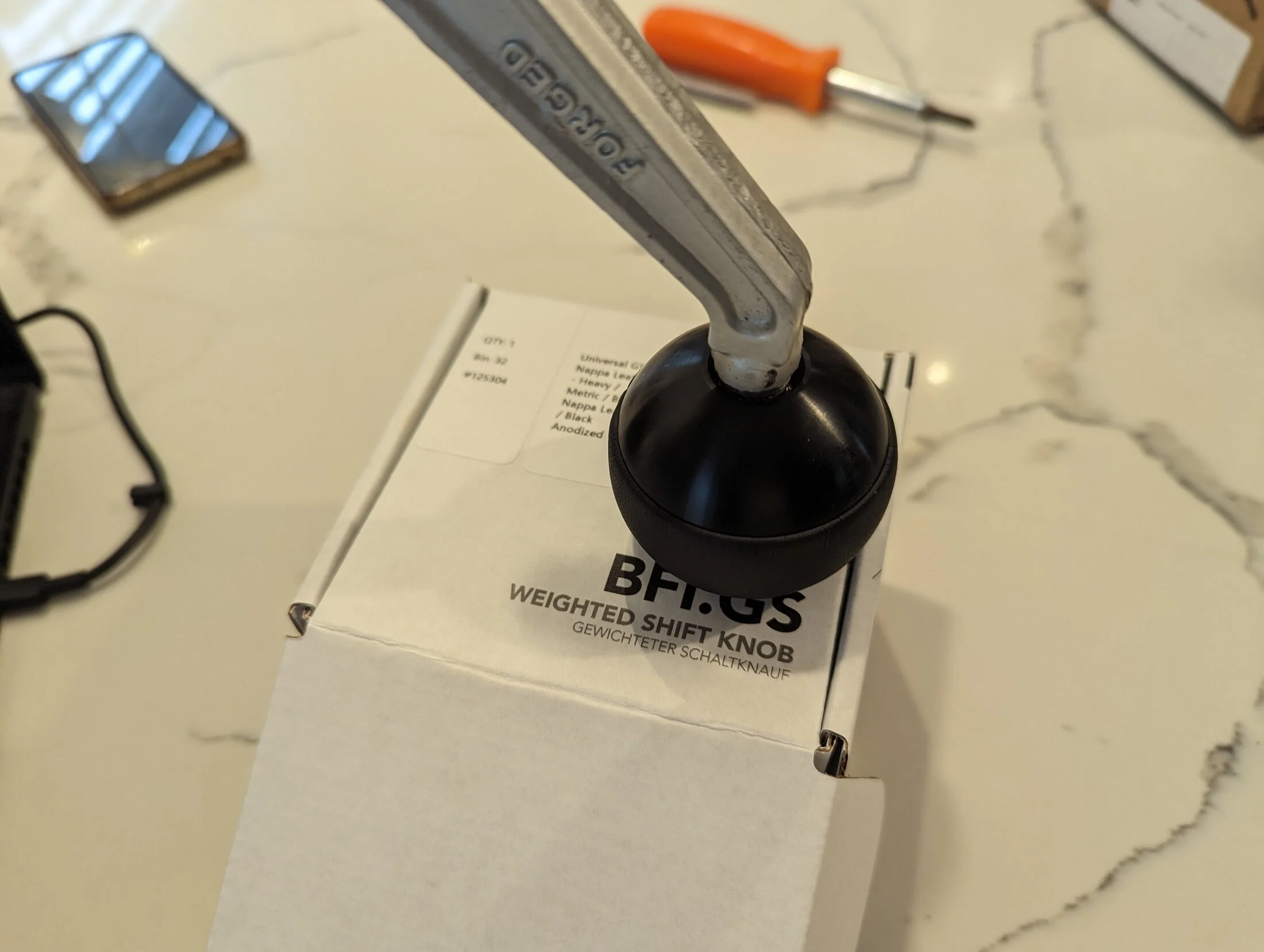

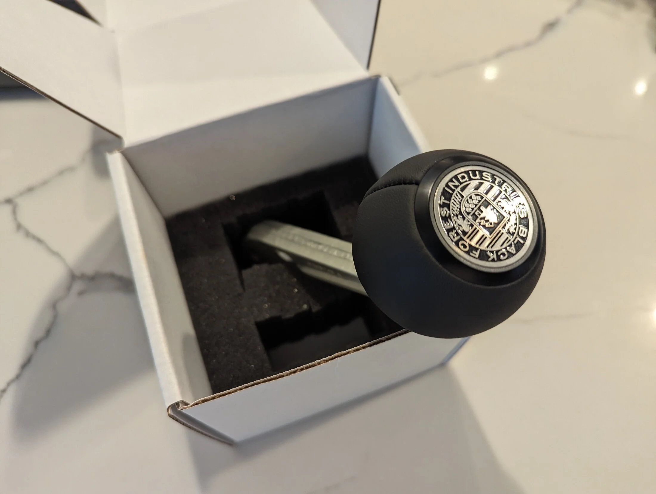

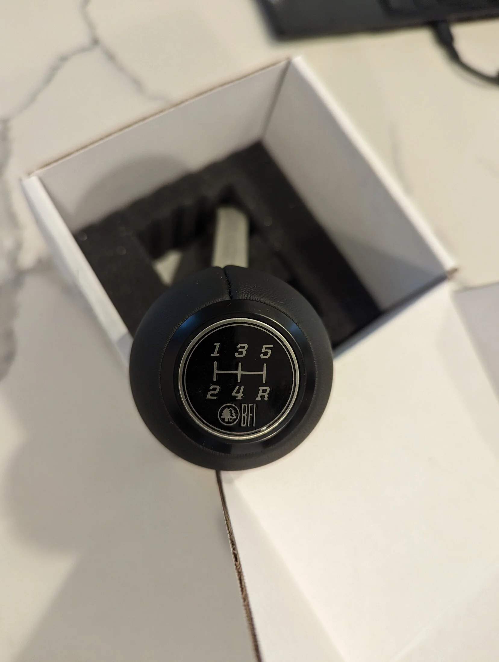

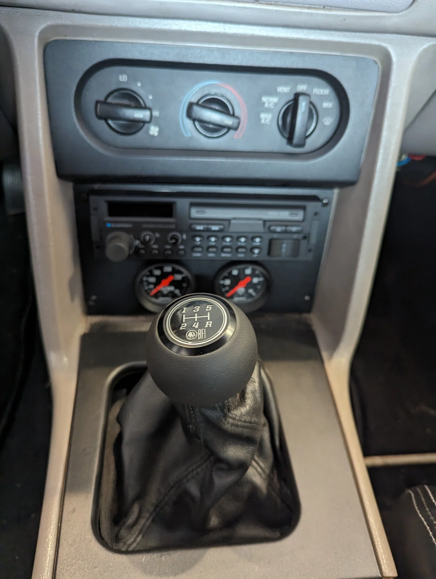

So I'm rarely happy with any shift knob (and I'm picky about the interior look) , ran I to this company black forest, they make all kinds of parts. Mainly for imports and high end porsches.
After a little digging they have a universal knob. They use adapters to fit them to any car.
Didn't see what I wanted. So emailed them with a request and an hour later they emailed me and it was listed on the site to buy. Seemed too easy and since I requested it, I felt like I had to buy it. Lol So I did.
Its a ball, 2/3 wrapped in leather and weighted. I don't mean a little weighted it's seriously heavy for a shift knob. My guess 5 times the weight of my Ford racing leather knob. Comes with their coin and I also bought what they call a longitudinal 5 speed gate.
Did not come cheap, but feels awesome and fits my triax test handle I keep around. Tomorrow I'll install it.

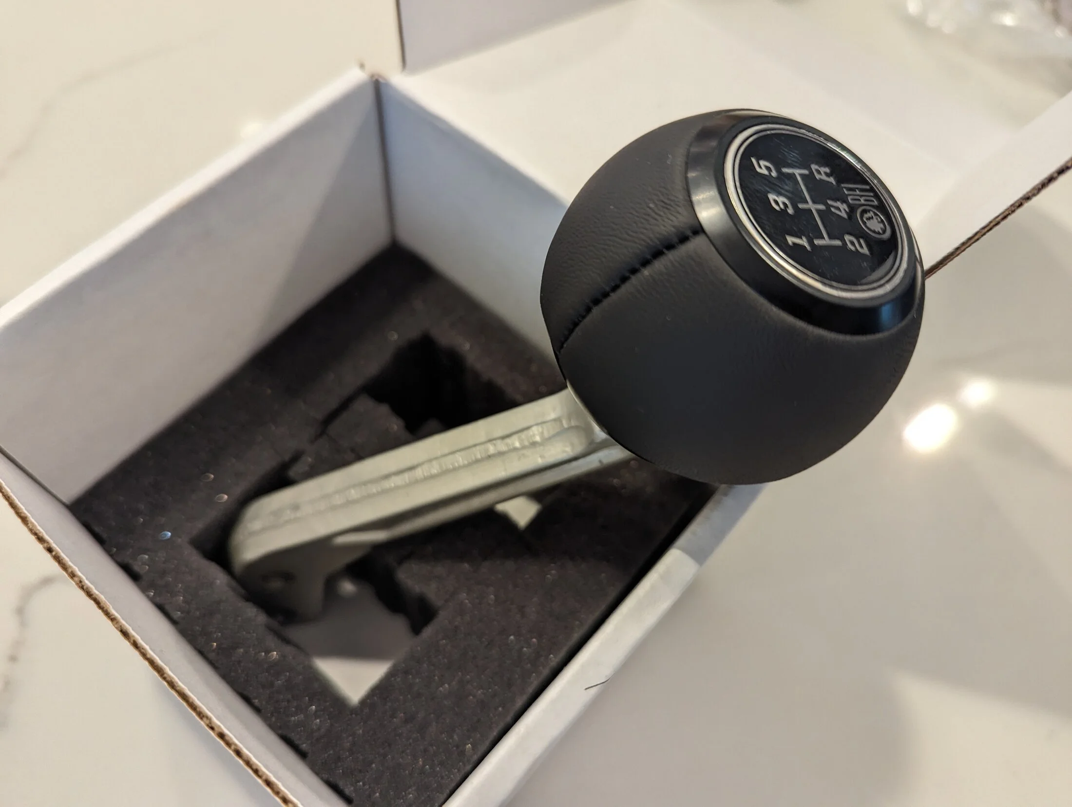

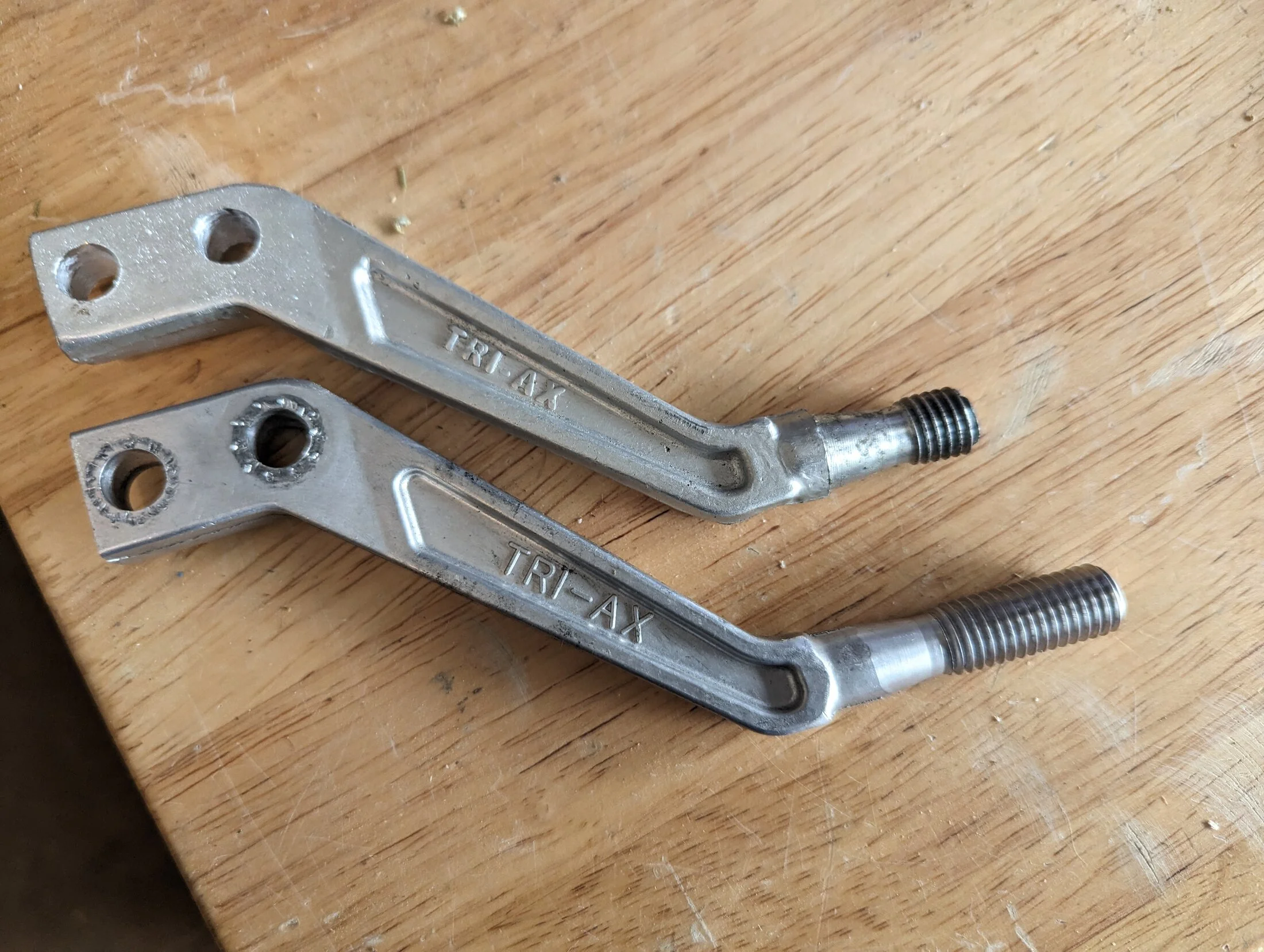

So Turns out i had to drill out the pass through bolt holes on my spare tri-ax handle. Since i never used it i didn't realize that Promotionpowertrain must have drilled it for their short throw shifter.
Also, like all the other shift knobs i have experimented with the threaded section of the handle is just too long. I had cut the spare down years ago.
So that's the one i had to use on the car.
Haven't decided the coin yet, but judging by the fact that it's aluminum with 3m tape on the back, odds are if i change my mind the one i pull out will get bent, so it's semi-permanent.

Now that i'm home, i found the one they put up for me. It's on sale for about $20 less than I paid.
To be clear, the price goes up from what you see. Adding the heavy weight option adds $10 or so and another coin is another $12, then you have shipping. Mine came out to $232, pretty steep for a shift knob, but when something is right, it's right and you have to pay up.
The sale might get you closer to $200.
They make them to order, so it took about 2 weeks to ship, then came in 2 days.
