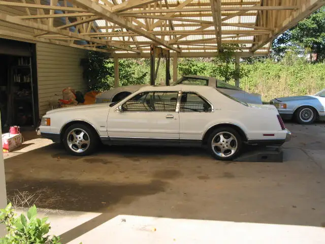

I had those wheels on the front of my coupe while i was waiting for my tires for my '98 split spokes and the centercaps fit w/no problem. As for the split spokes I'll have to put '95 stuff on to get the centercaps on. Good luck with it
These I think are mid 90's Cobra wheels, they fit with no problem, including the center cap
YES...the waffles will fit fine, even the caps....Those 94-97 Cobras also fit good, along with 17" Tri-bars. Only the "Dished" wheels don't fit good with the Mark VII conversion because the caps don't have enough room. The dished wheels being the 17" split spokes, and the newer GT wheels..
