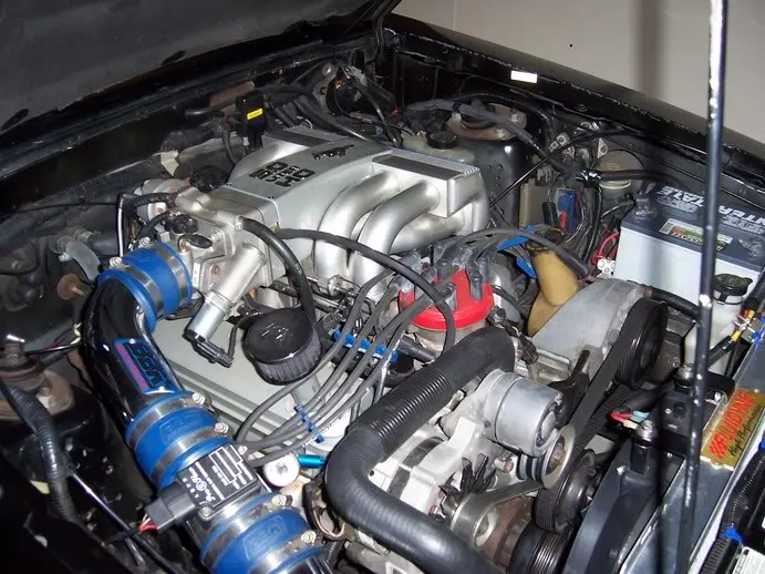

You can easily run without that idler pulley. I have no A/C or smog pump. Unfortunately I forgot the belt size though.
I have all my engine may pictures on my other computer, but maybe this will help.
