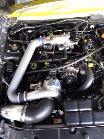

I don't know what supercharger installed on it but that's the picture of the engine

That unit would be from Vortech. It also looks like the coil packs, throttle body and upper plem have been changed. Seems like the car has a fair amount of aftermarket parts. If all runs well with it then it may be a good deal as long as the price is right!

The price is $8,000 it has 118,000 miles on it
As said before 118k miles on these vehicles is not a concern at all if the vehicle has been well maintained and serviced. That being said, a Supercharger CAN cause some premature wear due to the additional stresses placed on the engines internals during hard driving which WILL happen because it's impossible to resist. I'm not sure where you're from or what the overall condition of the vehicle actually is but 8k isn't too bad for an 04 that has been well cared for and modified tastefully.
