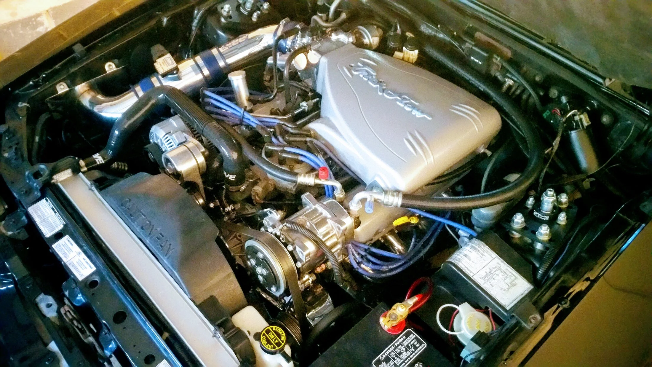

Honestly I've only heard of the BBK whistling, I still have the original IAC and have a 75mm Accufab with no whistle.
