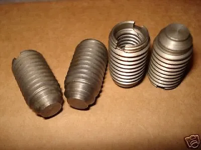

Somehow during a timing cover gasket swap, i lost the bolt that goes on the lower ear of the alternator, the one that goes through the passenger head. does anyone know its specs? Or where i can get another one. dont you just hate when you lose ****, and your car is one bolt away from running arrgghh :mad: :D
The bolt itself will be 7/16th's. To determine how long it needs to be measure from the front of your bracket to the side of the cylinder head and add a 1/2". It's just a regular bolt that screws into an emission plug like these.
Edit:
And it's course thread too, btw.
