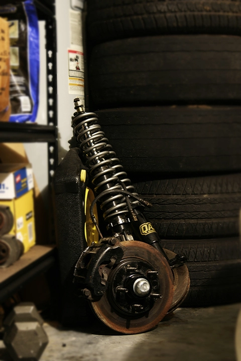

I picked up a used set of fronts today for $400 with about 25 miles on them like you described srtthis, they are QA1 struts and springs, and the actual body of the strut is threaded, not a sleeve. And he gave them to me on the spindles with 5 lug brakes on em too, not a bad deal. The only thing though I am not sure if the spring is going to be good for my application. They are 14-175lb, I am looking to lower my car a good amount and mostly street drive it. The guy I picked them up from was a guy off craigslist, showed up to his house, he opened the gate and brought me back to his garage with like 4 race cars and a lift. He says he buys race cars and sells them, he was parting out this fox mustang he had.
looks like a nice pair, once you go coilover you'll never go back~!!!
