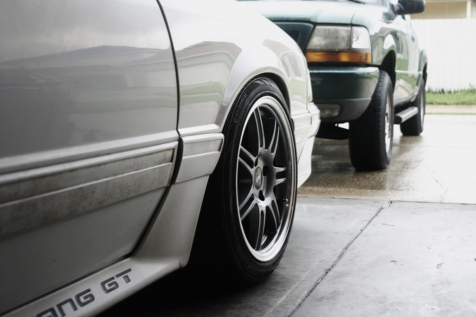

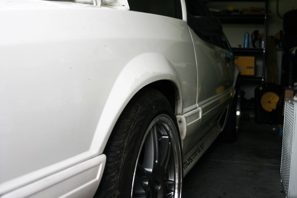

Got one side all finished and lowered today, just to let people know if you plan on running large wheels up front you will most likely need a spacer. I had to use a 1/8" spacer for my 9's to clear the strut and could really use another 1/8", clearance is TIGHT.
CC's on one side lol
Other side on springs
