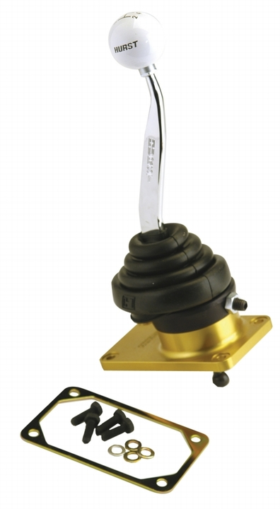

Hurst makes long handle shifters for the TR-3650 and the T-56. Its a long chrome handle with a white ball on top, the classic Hurst look.
I think it would look awesome in my Cobra...
