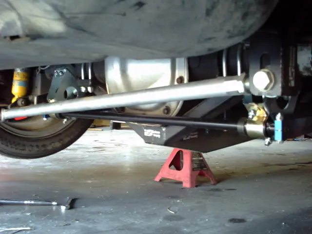

I have MM's entire catalog on my car, it handles EXTREMELY well, and as for the straight line i was able to pull a 1.99 60', 8.9 at 80mph on a bone stock engine, ride is a little rough cause of my dampeners but i like it like that. The car is very predicable doing anything, cornering or drag racing, **** when im in the burnout box i dont even need to keep my foot on the brake, i have zero wheel hop, and i can take turns WAY more confidently than i could when stock

The lowest portion of the TA is directly between the wheels, So its impossible to scrape it on speed bumps, the only portion that hangs near the center of the car only hangs about an inch below the subframes, even as lowered as my car is, i have yet to even scrape my subframes, i scraped my long tubes once, and after that it never happened again
