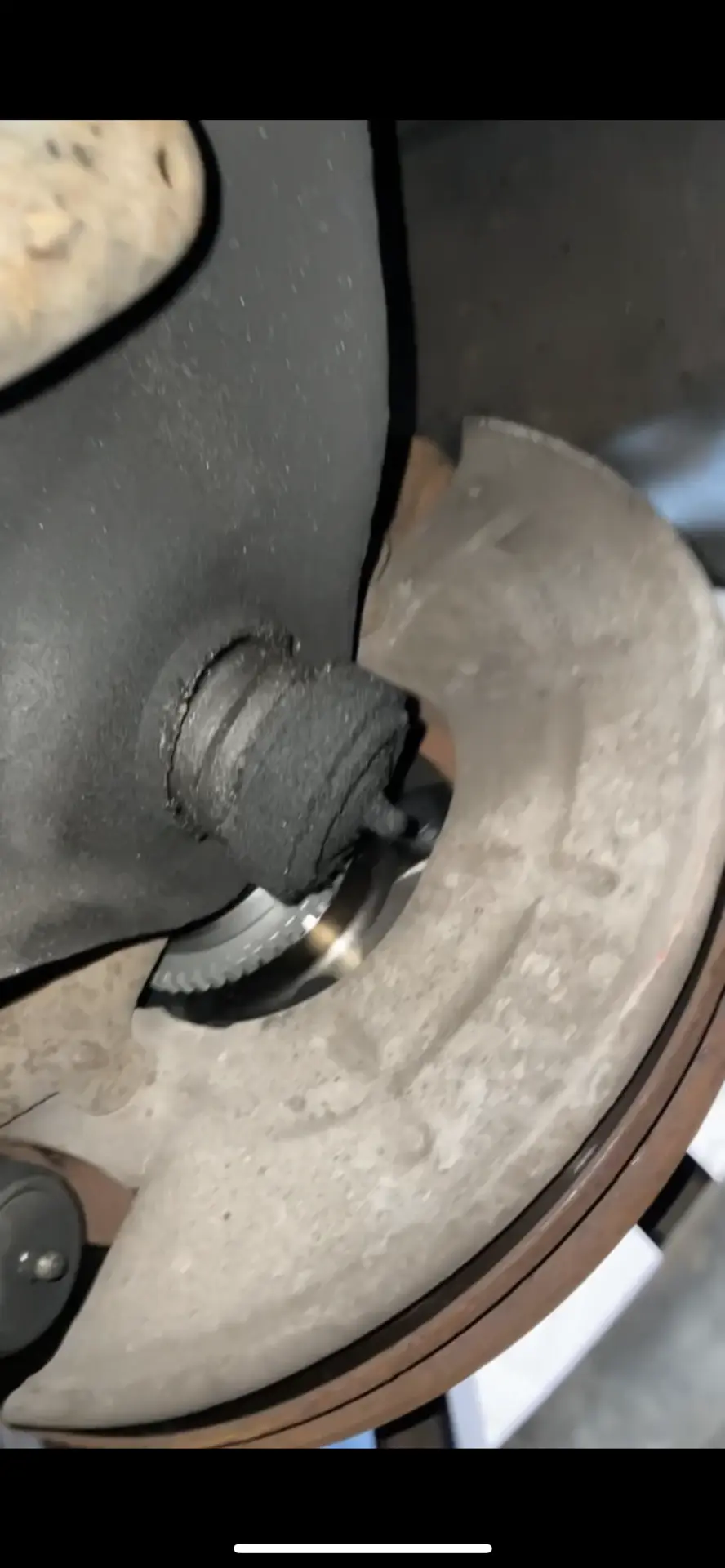

Look at your ball joints so you don’t end up like me
