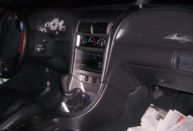

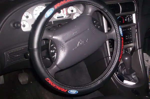

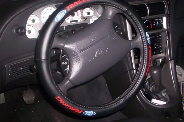

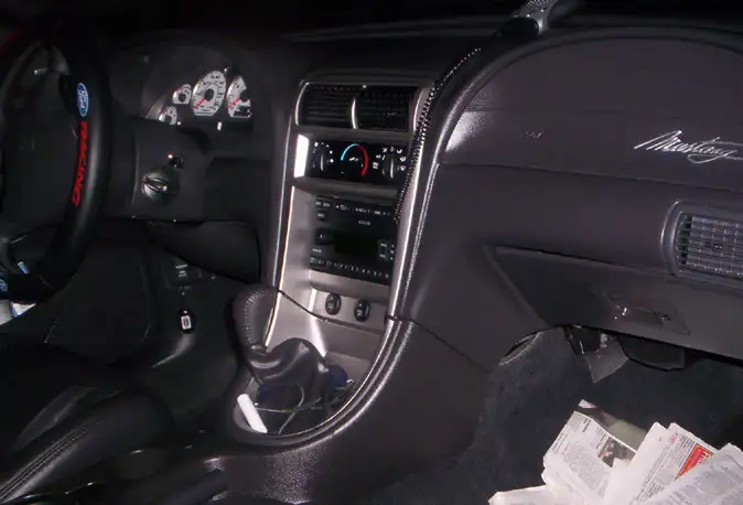

Your way sounds like it should look sweet. I'm lazy. I cleaned the parts with my gf's fingernail polish remover, then painted with silver and then a clear coat. Cheap paint from parts store. I even did the mustang lettering. It's been on for 5 months or so and no problems.

[QUOTE='03GTinFLA]Your way sounds like it should look sweet. I'm lazy. I cleaned the parts with my gf's fingernail polish remover, then painted with silver and then a clear coat. Cheap paint from parts store. I even did the mustang lettering. It's been on for 5 months or so and no problems.
[/QUOTE]
how'd you do the lettering? was it hard? my bf wants to do that & the horse on the steering wheel. i think it'd be hard to do, but if you did it.....maybe i'll think it's not a bad idea after all :D
the horse on the steering wheel is a NO NO, unless you will NEVER use the horn. Remember its very flexible vinyl there
I wouldn't think the horse would flex, would it. It's thicker than the surrounding vinyl. I was going to paint mine when I touched up the lettering, so I'll let you know how it goes.
Besides, I don't use the horn, I use the finger. All the Q tips on the road down here are deaf anyways.
I used a little bottle of touch up paint from autozone or napa or something. IT has a roller ball on one side or you can flip the tip and it has a small brush end. I used the brush end. It's more time consuming than hard. Long tube install was hard. It's been on there a long time but it has flaked off in a small spot so I'm gonna re-apply soon. And if you mess up the pony just take some nail polish remover and wipe it off. :nice:
