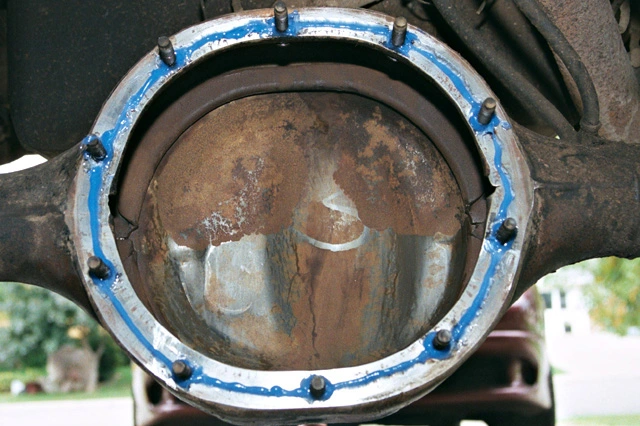

that kit is fine. BTW DO NOT USE THE GASKET. i have seen horrible leaks on cars people used gaskets on. all mine get rtv and none have comeback.
It is a silicone that squirts out of a tube, it is the blue stuff in the pic...
