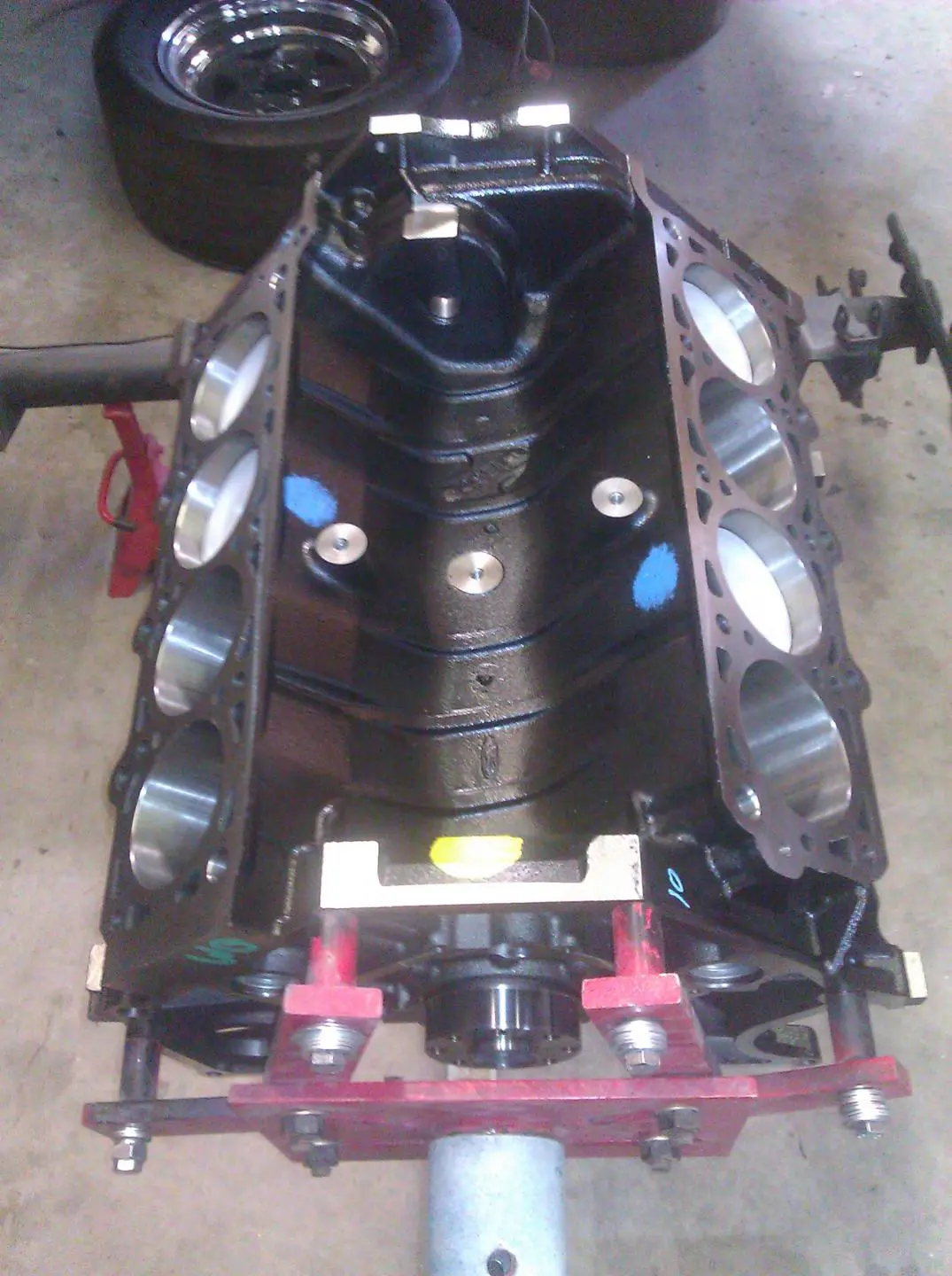

Alright guys here it is!!! MMR Stroker Mod 1000S with all the goodies :burnout:
Now Im just waiting on my stage 2 turbo cams and stage 3 heads from modular headshop. Thanks for the pointers Stumbaugh. Cant wait to get the turbos!!!
