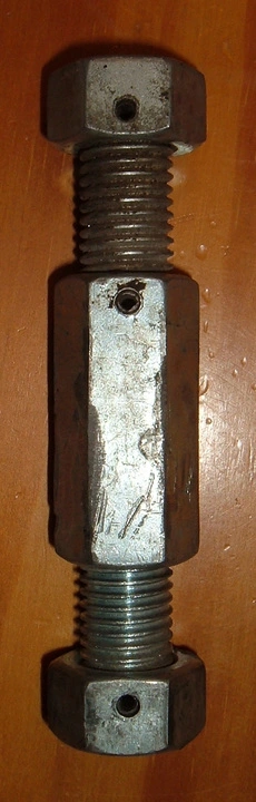

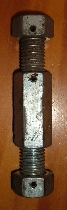

I have herd really good things about his disc brake swap. If you want a really good trick for removing the ball joints make one of these
You can take the nuts off the ball joints, place this tool between the two studs and expand the tool. The ball joints will pop loose with out having to use a pickle fork, having to pound on the end of the ball joint with a hammer, or damaging them. There are detailed instructions on how to make one (not that it is complicated :) ) at the bottom of my homemade spring compressor page. http://home.bresnan.net/%7Edazed/spring

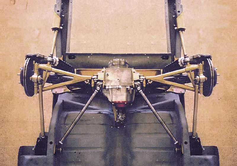

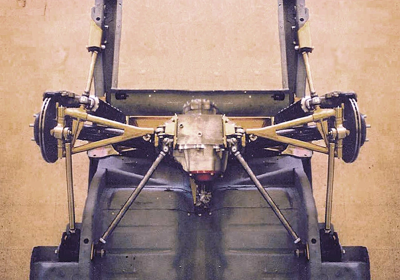

Arning did develop the drop as part of a performance suspension package that did include IRS. Many 63 and 64 Falcons were tested on and it was these cars that the Mustang IRS was installed. 4 or 5 cars (all falcons but 1) got the original Ford IRS put under them.
