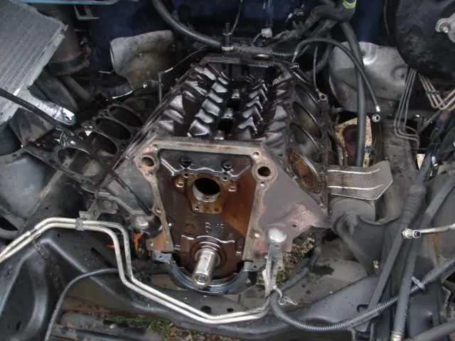

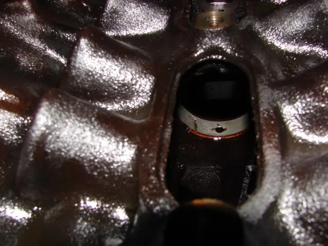

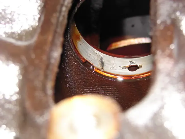

Well good news is my heads, and the cam degree kit and push rod length checkers I'm borrowing off a Mike (Low5.0) came in today. I got the cam removed, got the gasket surfaces scraped off, Got a few coats of paint on a bunch of the parts.
Bad news while cleaning the cam bearings I found one is is all tore up. Another one has dings on the edge. i will be ordering these either tonight or tomorow.
Pisses me off that I found this. In a way I'm happy though. I could have not changed the cam and had the bearing blow apart and totally screw my engine. Then I would have to go through this all over again
I also found after cleaning my pistons that most of them have then knicks out of them like the 4th cylinder has. Me and pc looked at my old heads and the valves look fine. I don't know what would cause this to happen.

Well after farther thought and recomendtions I've run into more bs. I'm gonna pull the motor out and replace all the bearings. Everything that has come off was hiding some kind of suprise under it. It has taken a lot of thought and I hate to do it but I'm thinking ahead. If i was to not do it and a main bearing went out i would be back at this again. Also my pistons are all gashed up and the more I think about it I should change them cause nobody can figure out how they got chewed up.
