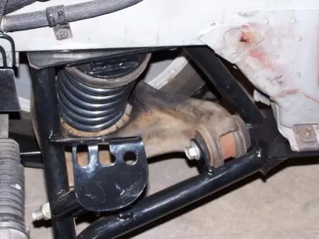

I have bought a QA1 K member, and had a major issue with the fit. My whole front suspension shifted about 2 inches. I have since bought a PA Racing K member and have no problems at all. I am going to post the pictures of my car with the Qa1 set up so you can see how bad it is, and then I am going to post the e-mail I recieved from Qa1 regaurding the problem. If you are considering buying one of these I would advise strongly against it because they don't support their customers or their products.
At the time I purchased this part, I did do my homework and found no negetive comments about QA1. I am going to make it my mission to make sure that anyone in the market for this part will be weary of QA1. I also forgot to mention in my oringinal post that the car has never seen an accident what so ever! I will however say that Pa Racing rocks, and is definately worth the extra $$$$.
Yes, it was aligned correctly. The K mounted up OK, but it had adjustment to move from front to back, not left to right. No matter how many times I shifted the dumb thing the result was always the same. Why would my stock k member fit fine and the one I bought from PA Racing go in perfectly and not this QA1 piece? I paid to have it shipped to me thinking it should be a great fitting part, then I paid to ship it back to have it inspected, and now they want me to pay to have a crooked non fitting K member shipped back to me. At this point I feel they have an obligation to exchange it for another K-member, or refund my money. Niether of which they are willing to do.
Here is a pic of the inside. I am using stock a arms, however I did follow the instructions and all of their suggestions to the letter! If this can be used by someone else with their A arm setup with no problems, I would be willing to sell it cheap. However I don't want to pass this problem off to someone else, I just would wouldn't feel right about it.
