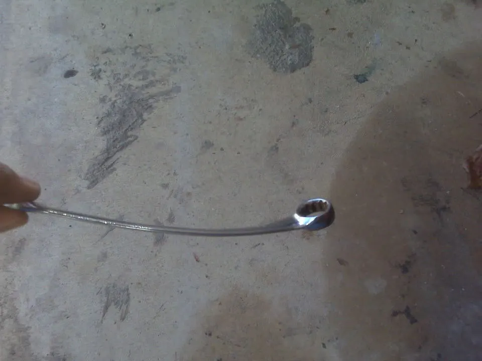

don't think these bolts what to come out

:notnice:driveshaft bolts FTL
that was with a 13/16 box end for a cheater bar with WD40 and a propane torch. ended up pulling the U joint out so i can get the rear out from under the car. ordering a 12pt impact socket from mac and going to get those lil bastards off

i recently had the same problem when doing my t5 swap.. i snaped 2 wrenches with a 2 foot breaker bar.
so how i got em off i bought a 12 pt socket instead of a wrench and sat my propane torch right on the bolt the hole time with a breaker bar and finally came loose! all 4 bolts were that tight!
