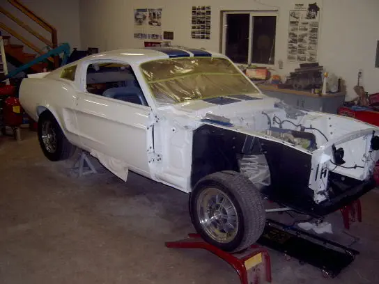

You don't need to take the fenders off to get the door hinges off. It does make life easier, but you can get the hinges off (at least on my '68) with an air ratchet and patience. Put a floor jack covered in a pad or thick towel under the door to catch it. But if you do decide to take off the fenders, you need to get the bumper off, then the front valance, remove the bolts that hold the fender to the radiator support, then there are the bolts on top, one on the bottom near the door opening and one that's only visible if you open the door and use a long extension, it's at the top of the front fo the door opening. I also unbolted the splash gaurds (front and back), then they should lift right off. Also, regardless of whether you remove the fenders or not, be VERY carefull when removing the hinges from the body, the door jamb itself is not threaded, but there are plates that are VERY loosely held in place that the bolts go into and they can easily be knocked down inside the door jamb. It's not that big of a deal, but you have to remove the inner kick panel to get it back in place and it's just one more pain in the butt tha can be avoided. Make sure you clean all the bolts (they're always crusty) and seal the hinges to the jamb with some RTV sealant to prevent water from getting into the door jamb through the large, square openings the hinge bolts pass through.
I know it doesn't show very well, but if you look closely you might see a tab at the top of the cowl where the hidden bolt attaches to in this picture. You can also see how much stuff needs to come off, but if you're planning on detailing the fenderwells and such, it'll be a good project for bad weather.
