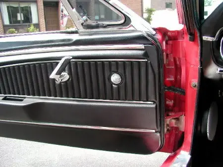

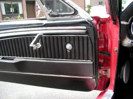

We're about to install A-1 Electric door locks and power windows in AdamInChains '65. Included with the kit are rubber bellows approximately 4+ inches long. They appear they could be a little short when the door is opened fully. For those of you who have installed power windows/door locks, have these worked ok for you or what did you use?:shrug:
Same kit here:
They are working fine, but make sure you are going from inside the door jamb to inside the door jamb. You are going to need a right angle drill to drill the holes.
Tim
i did a power window kit in a street rod a while back that used tubing sort of like lavitory supply lines (straight tubing with a flange on one end) any chance this is what yours uses? if so a trip to your local home depot would score you tubing that is plenty long enough. btw, if you can get a straight shot, you can drill from inside the door, and hit the door jamb all in one shot.
