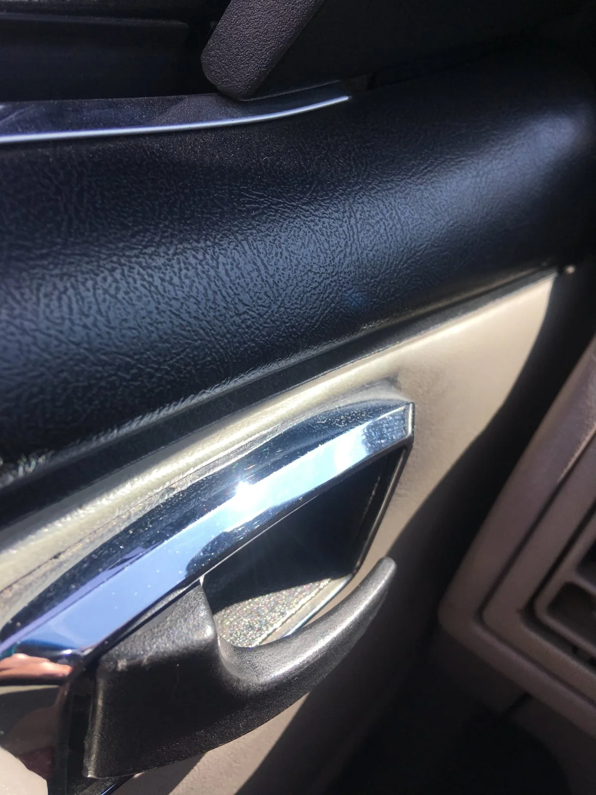

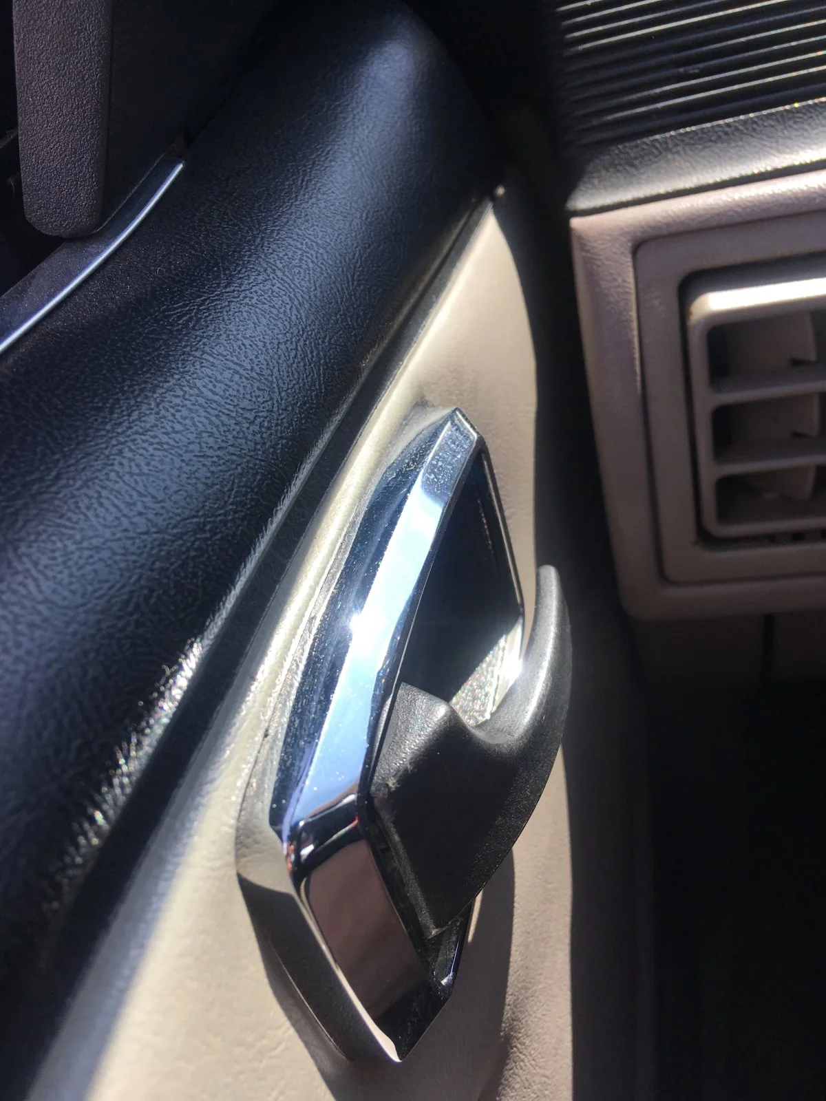

I need another opinion before I dig into my driver’s side door lock and inner handle system.
1. The power locks work fine, but when it was cold and wet, something froze, and the lock rod came out. The key unlocks fine, but I am worried about breaking the key to lock the door because it is so hard to turn. I want to spray the back side of the lock with WD-40 or liquid wrench to free it up, then garage door dry lube before closing things back up. There was way too much gummed up lubriplate in the passenger door parts when the power lock went a few years ago. Any other ideas on what might be needed?
2. The inner handle on the driver’s door sticks out more than it should when closed. Is there anything to adjust or bend to fix this?
The front tip of the inside handle just does not fold back in all the way, 3/8” maybe? It looked ok with the honking Billet trim, but I ditched that for the stock ones. I can get General K’s pics tomorrow in the daylight.

I took the rod out of the drivers door years ago as the actuator failed twice (Ford replacement part). Passenger side is still power. No leaning across the seat to open/lock the door that way which is nice. I never missed the drivers side power lock. Passenger side is very hard to lock manually. Drivers side is easy as pie, just no power. My drivers side handle does stick out a bit though like you mentioned, I just never noticed it before reading your post. As a guess I'd say mine is from use. It's a plastic handle that gets warm in the summer. Most have 30+ years on them.
Here is the follow up. The outside handles were replaced before I got the car, and EVERYTHING was drowned in Lubriplate spray that was gummed up. The lock cylinder was gummed up. It is cleaned and is OK. The bear claw latch had some rust under the lube gunk and was not working well. It cleaned up and is fine. The actuator wore out from working too hard and was barely moving. The parts places in town would have to order several days out, so the door is back together for now with the solenoid disconnected on the driver's side. I replaced the passenger side with (I think) a Napa part 5 years ago that works well, but does not go THUNK.
