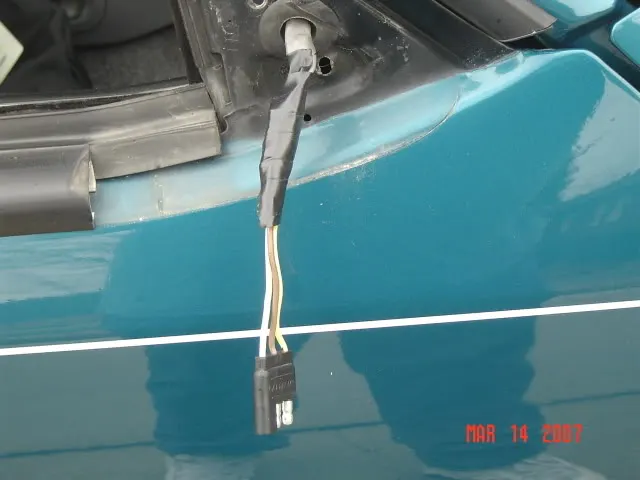

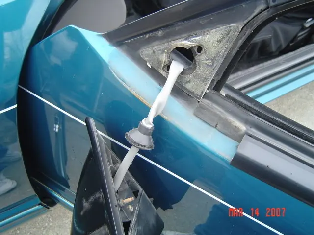

I took care of the power mirror problem of having to pull the door panel. I used a trailer type connector (3 pin). This way if I ever want to take the mirrors off to paint again :rolleyes: Then it is a lot easier.

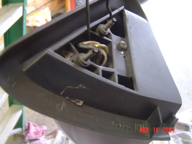

Also when you take the two nuts off from the mirror studs, be careful, they can fall down in your door real easy and then you got to look for those lost nuts or get some new ones.
