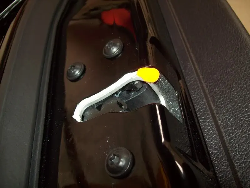

I washed the Stang tonight and decided to locate the source of the water that collects in the lower door frame Mustang placard. It is coming thru the door latch. I poured water outside slowly down the window and watched it pour out the bottom of the door (which it should) and also out the latch. I don't think it should come out the latch. Insulation is missing somewhere!
I plan to get some putty and seal around the door-latch junction. That should fix it...

The premium models with the accent lighting have the illuminating MUSTANG on the lower sill as the doors are opened. I was concerned about the water that was apparent in the area. As the service guy said, those units are sealed.
This pic was taken from the bottom looking up at the door latch.
LOL...I'm proud of this as an example of genuine Okie engineering! I applied some plumber's silicon grease to a strip of water valve packing and forced it up into the narrow latch-door gap. At the corner, I sqeezed down an ear plug and placed it into the gap where it expanded filling the gap. I then cut the excess off.
It may not keep out all the water, but I can guarantee that it won't be a stream! This will do until a fix is formulated by Ford...
