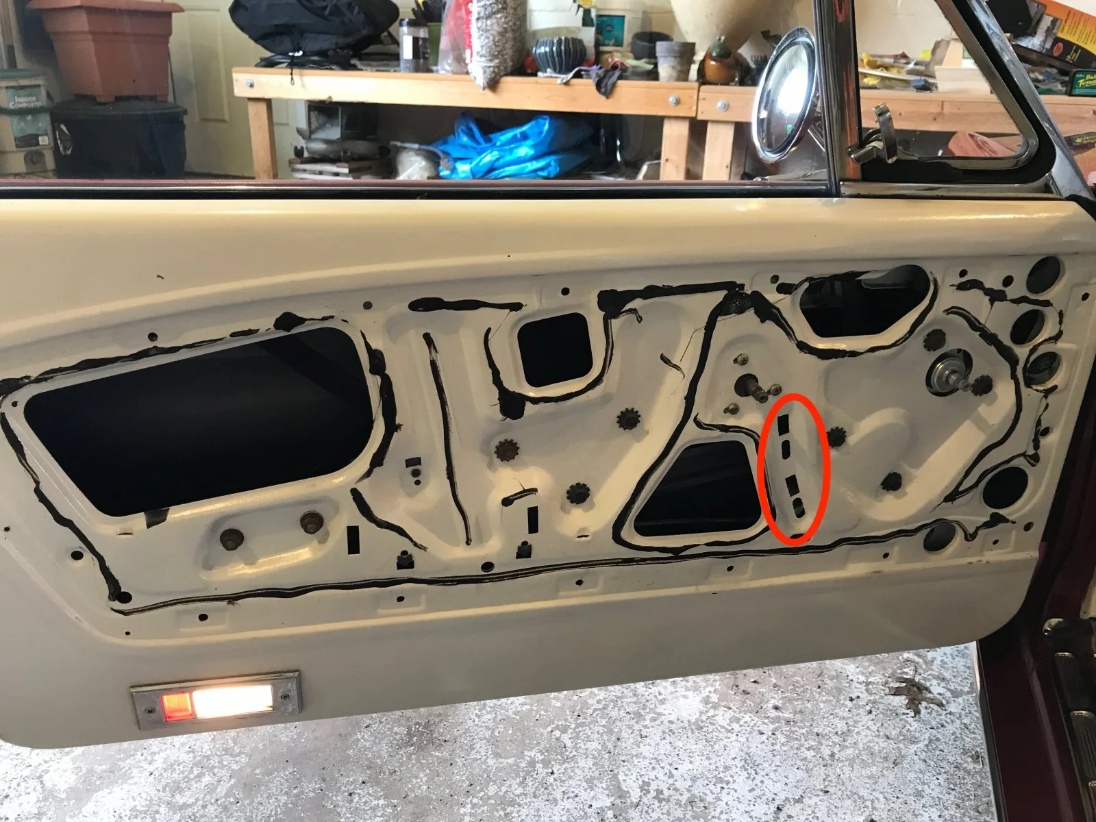

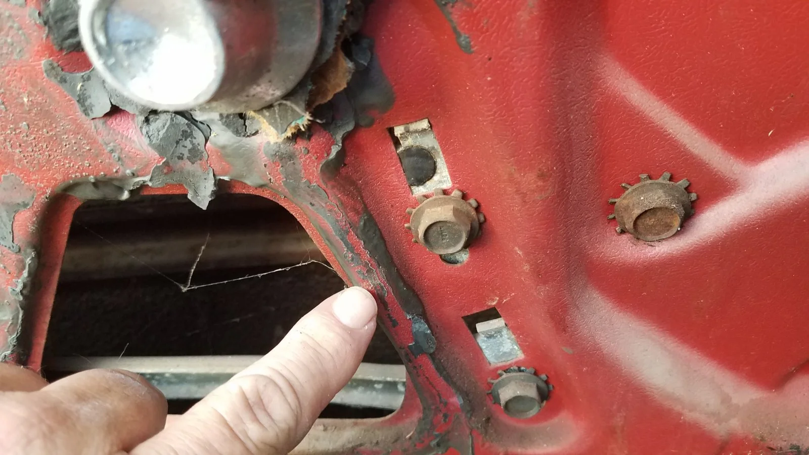

Are you able to help me in detail with the issue of my driver's side door window being able to move back and forth (toward the engine and back) when in the door? It keeps sliding backwards and causes issues when closing the door the windows touch. I understand the track the window slides up and down in, but dont get how the bolts near the latch adjust this. Here is a video of the window movement :
View: https://www.youtube.com/watch?v=nrg4s40CVA4
Also notice im missing two adjustments here I see in other videos. What goes here and are they needed?

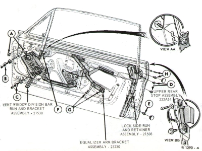

Not sure but I do appreciate your time. Almost wondering if there is a way to push the rear channel the window sits in towards the front of the car? Because my trouble is when the window is towards the back of the door, not the front. the rear channel just bolts in the back of the door so dont see a way to make it pinch the glass forward.
