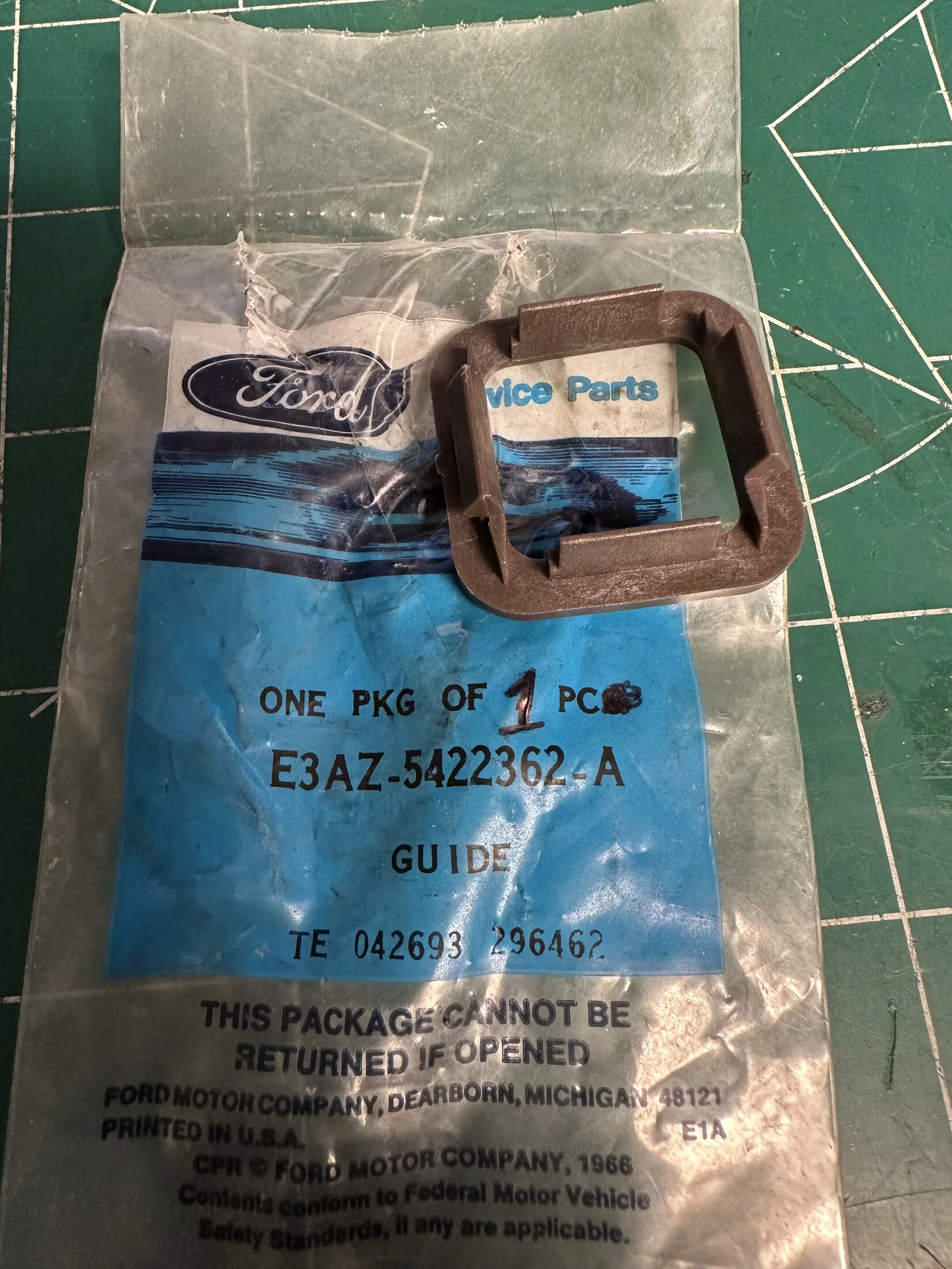

I scored a set of NOS window bushing guides on Ebay a while back, but when came time to install i used the aftermarket ones. Been a few years and they still roll up and down nice and tight.
NOS ones still patiently waiting in case, but so far so good. I can track down the part number if anyone wants to try and find them.
Daniel Carpenter makes the square door window guides for the 1981-93 Coupe/Hatch, 1981-87 Conv/T-top & Early 88 Conv/T-top with flush mounted mirrors, and 1983-93 Conv quarter windows P/N E3AZ-5422362-A and the one for 88-93 Convertibles P/N E3ZZ-6622292. (you need two each for each window). They also make the door window regulator arm roller P/N D6AZ-5323240 (again, two each per window). Blue Oval Parts has them for a reasonable price and free shipping.
