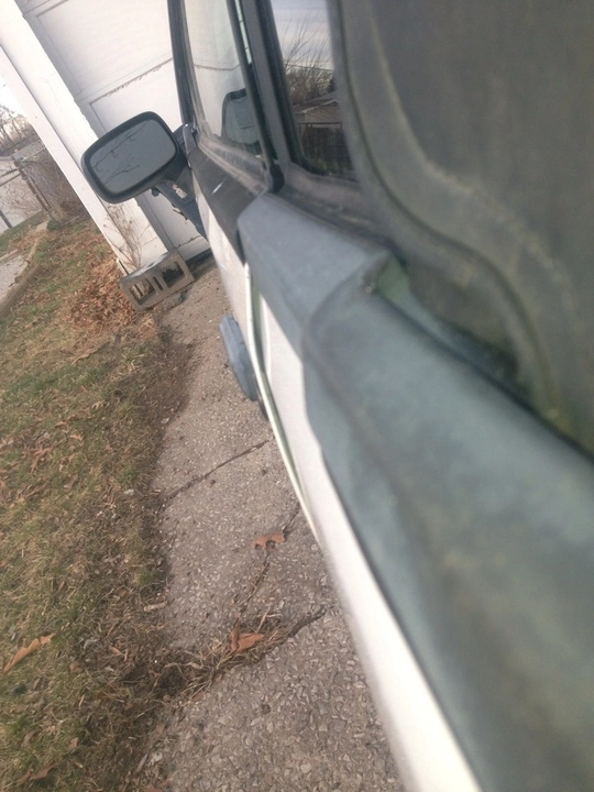

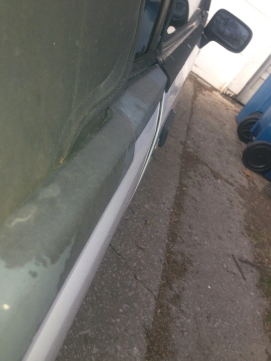

Pics say it all, window bushings are totally missing on both sides. Doors shut fine minus being a bit off..
Pics below

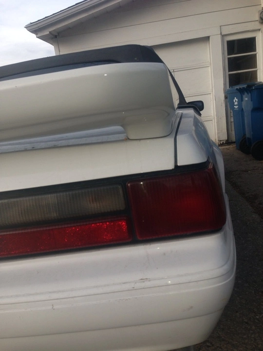

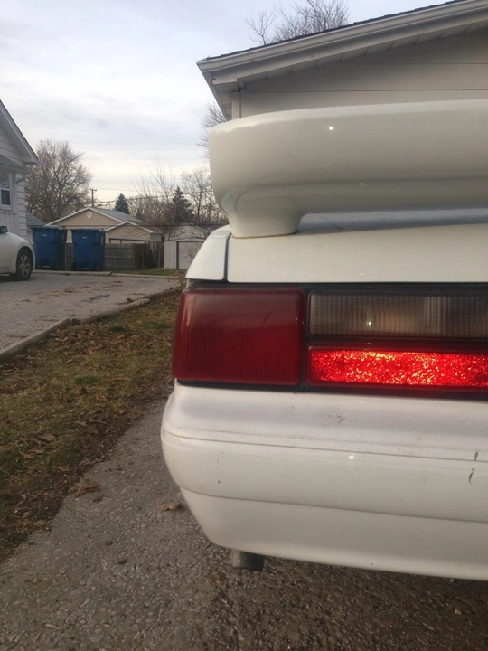

The trunk is my main worry, minus the latch, all the hardware was removed. Not sure if there are some kind of bumpers I'll need..
As far as the doors go, I already ordered window bushings. Once they are in I'll see if the rear windows will adjust at all, but I'm starting to wonder if I need new door bushings. The doors close minus the top not closing as far as the bottom, when closed, I can push the top more closed.. Unless I can adjust the striker..

The striker is adjustable. You just need the correct torx bit. If you need new striker bushings, they are sold at Autozone in the HELP aisle. They are $9 each, and come assembled. Simple remove the old striker and swap the new one in place and then align.
Door bushing are also sold at autozone. A little trickier to install. Open the door all the way and lift it up, If there is slop in the door, then replace the bushing.
Bushings and strikers are cheap. Prob $30 in parts total and you get get both doors nice and tight

How is the alignment with the front of the door to the fender?

I asked because if the door is out on top at the front also, it could be your top hinge out of adjustment or worn out. Also, if the car was ever wrecked on the front drivers corner, it might not have been adjusted properly during the repair.

Found this pic, mine is missing the black bumper in the corner.. Needed?

Screw it, they were 5$ on lms.. Got a set on the way

Ok, checked door to fender clearance and the drivers side top was in about as far as its out on the other side so I think the striker might be the prob

So you are saying the front top of the door is "in" about as much as the top back is "out" correct?

Yes!

Either that door is tweaked, or both the hinges and striker are off. You said the bottom of the door is aligning correctly, right?

When I push it close, it all lines up fine..
