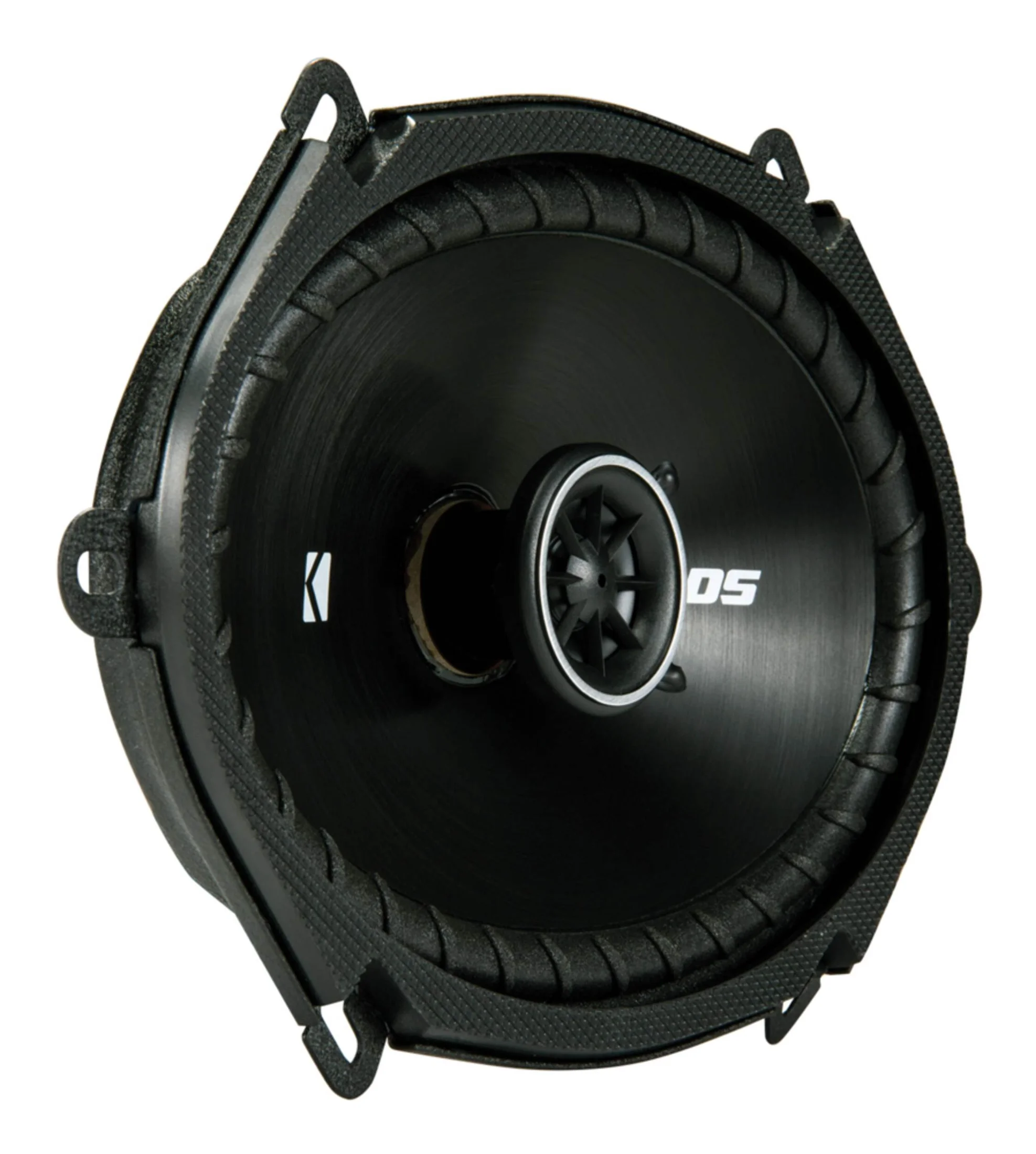

In my 91 coupe, I have these installed
Kicker DSC680 Coaxial 200W Car Speakers, 6-in x 8-in in the trunk, with​
Kicker DSC6504 DS Series Car Speakers, 240W, 6.5-in in the doors and​
Pioneer TS-A878 60W Max Custom Fit 2-Way Car Speaker, Pair, 3.5-in in the dash all powered off a double din Kenwood deck no amps and it sounds amazing.​

Did the door speakers mount easily or did you have to use any adapters or cut the doors to accept them?
No they all fit like a glove and mounted perfect in the stock locations. I was so happy they fit the doors no drilling or any thing they just fit perfectly.
