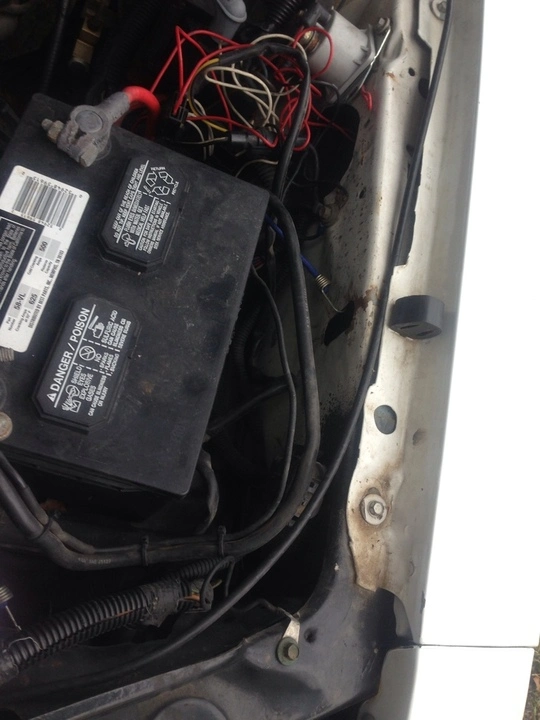

I took a tape measure and measured from the very corners of the engine bay, the bolts on both sides of the hood latch and the latch it's self each to the joint between the fenders and front bumper cover, unless I measured wrong, each measurement was either the same or so close I could'nt tell. Now the area behind the battery is banged up and the main thing I saw that looked off is the fender it's self, where it runs next to the cowl, it's been pushed in, I'll get several pics in the morning light.

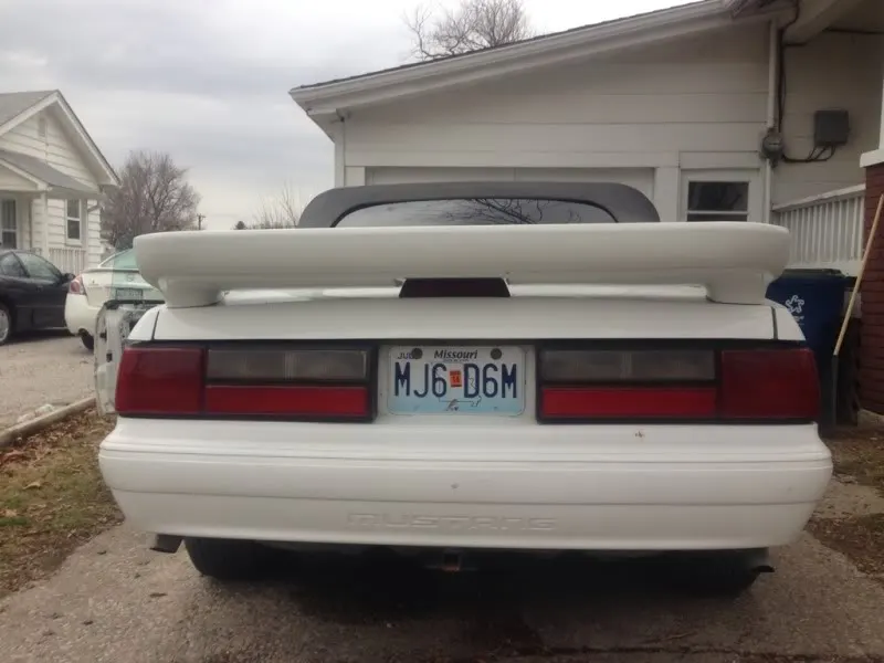

Adjusted the trunk and installed the bumpers, still could use a little tweaking but it's better.

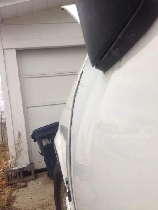

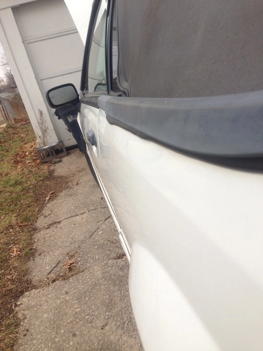

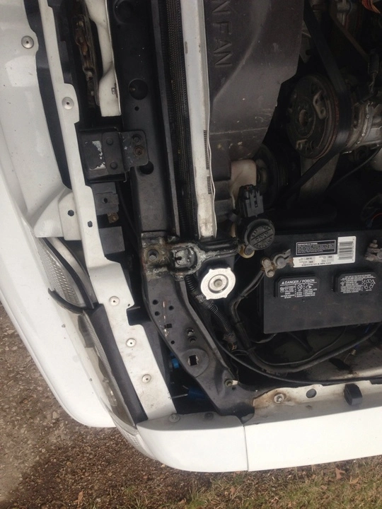

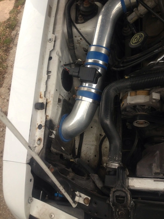

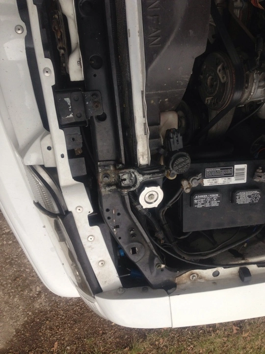

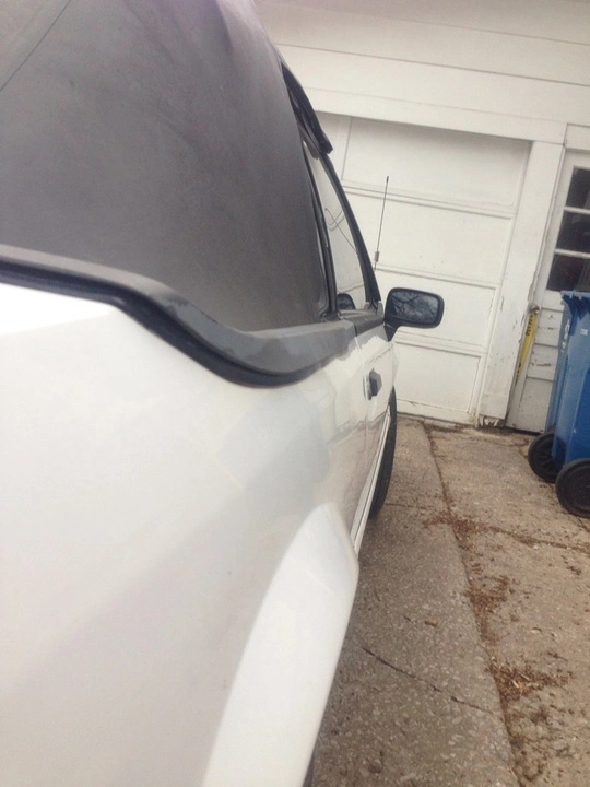

And now the adjusted drivers door and what looks like damage. Crawled under it and everything looks fine.

Your car is white, the hood prop and bracket are white, the hood latch bracket is white but your radiator support as well as underneath the driver fender is sprayed a different color. Notice the shiny/missing rivets on the front bumper cover- that was off. Incorrect fender bolts, no shims. Somebody trimmed the front of both fenders under the hood. The Window washer reservoir missing See how the driver side fender is sticking out more than the front fender extension piece and the fenders look like they are too far out from the inner fender . Why is the battery so far away from the fender. Those fenders were def off at some point and it looks like they patched in a new radiator support.
Any idea what all is needed for the window washer? I found the resivor , I'm gonna assume everything under the fender is missing, so the resivor, hose and what does it mount to?
