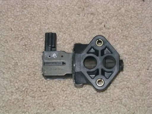

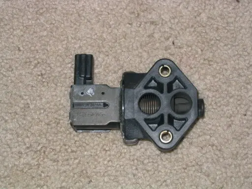

ok so first i took the IAC and MAF off. Now the MAF has those torx security bits on it so i cant take the piece i think i need off until i get that bit. I dont want to stick a q-tip down in there and end up breaking something. now on to the IAC. i have it off but now what do i do spray something in the two holes or what? heres a pic, looks kinda dirty

On the IAC....shoot it up with some WD40 all inside...let it soak a bit and use Q-Tips to clean out that crud....do it a few times over to get all that crud out...you should be able to move the plunger up and down once it cleaned up some..

ok well i cleaned the IAC up some. then walked down to autozone and just my luck the only bit they didnt have was that t-20 torx that i need. Oh well i'll put the IAC back on tomorrow without cleanign the MAF tomorrow and see if theres a difference. I'll have to find that torx soon though. Also hoping maybe resetting the computer might help.
