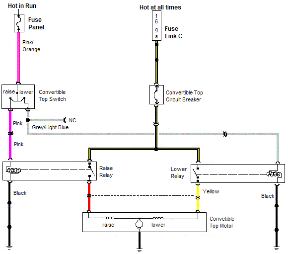

I've been in the hobby a long time but can't figure the last two problems out on my 87 "Drop top". I just got it. 1st If I lower the top either at idle or while reving it a the low oil light comes on . But not while going up :LOL And a more important problem is a somewhat rough running engine (I can feel it in the steering wheel) at more or less 1400 rpms. smooth below that and above that . Thanks in advance for any ideas.

Top problem: I take it that you are not the first owner of this car...
Electrical gremlins from two totally unrelated electrical systems means that you have one of 3 things:
1.) Low voltage due to a power delivery problem to the top.
2.) A bad ground in the top motor circuit - not so likely since it would also show up when raising the top.
3.) A miswire due to the efforts of the previous owner. That's why I asked if you were the original owner.
