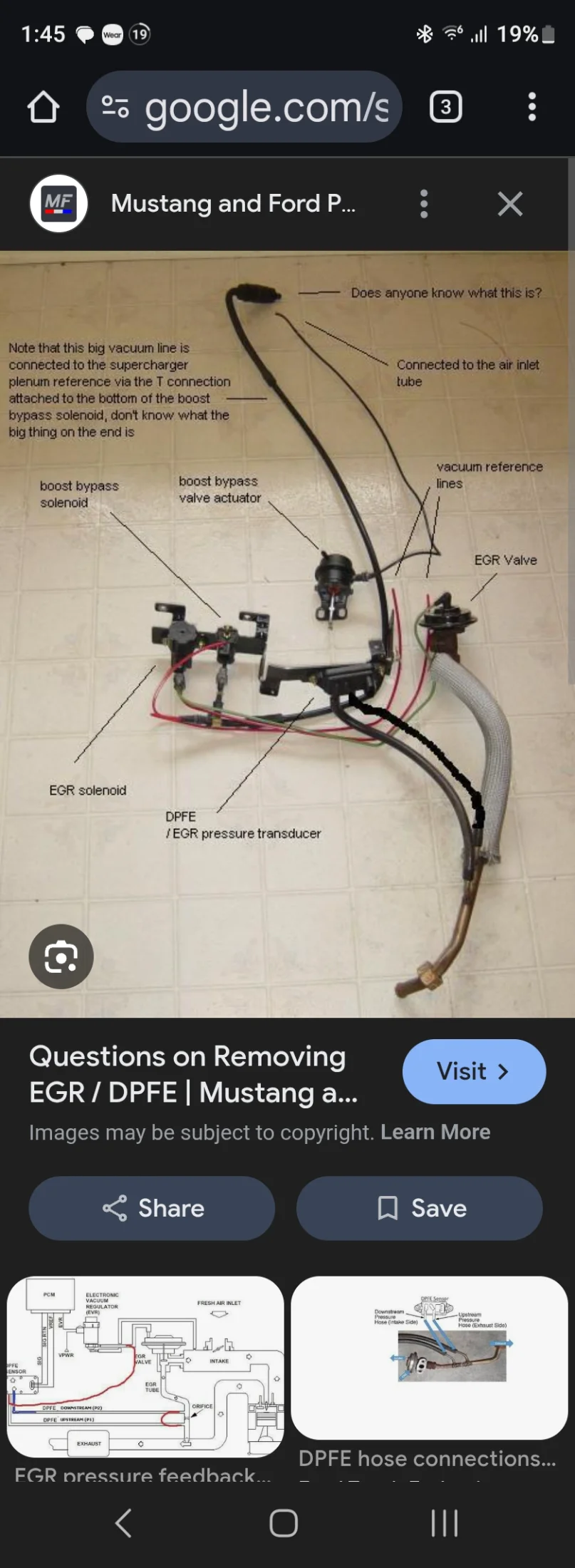

Here you go brother, hope this helps you
