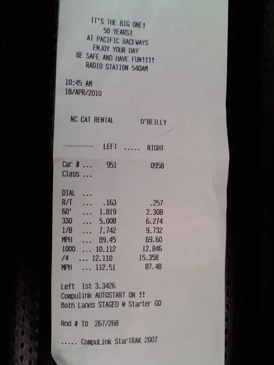

It was Pacific Racway's opening day yesterday, so I bolted on the drag radials, pulled non-essentials out of my '07 GT (spare, jack, rear seat, etc.) and braved a bit of light rain with hopes of a personal best run.
Took my handheld tuner so I could play with timing. My supercharger is not intercooled, so my custom dyno tune has just 14 degrees of timing in it. On the dyno, going with 16 resulted in the PCM pulling timing at WOT, so we went with 14 to be safe. However, at the track, I wanted to try a few different settings. I got three runs in...
16 degrees of timing. Computer pulled timing on me and the car just didn't feel right. Ran 12.425 @ 111.61 in the 1/4 mile on a 1.919 sixty foot.
14 degrees of timing. This is my normal street setting. Car hooked good and ran a 12.250 @ 112.18 on a 1.876 sixty foot.
15 degrees of timing. I knew it was my best run before I even got to the traps! Finished with a 12.110 @ 112.51 on a 1.819 sixty foot. This was the sweet spot!
The track was well prepped. Lots of VHT traction compound. I just installed a line lock recently so the drag radials were working their magic at 20 psi and hooking perfectly all day.
I was really hoping to see an 11.999 or better, but I'm about 20-30 rwhp short of doing so. Gives me something to work for this season!
Here's the slip from my best pass yesterday (I'm car #951 in the left lane)...

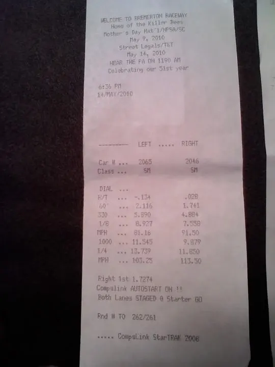

Just an update from my racing at Bremeton Raceway. I went May 7th as noted in my last post. Ran my personal best of 12.07 @ 112.5. Lots of 12.2's otherwise.
I went back to Bremerton Raceway last Friday, May 14th. After driving an hour in bad traffic, I immediately lined up and ran the car hot. A bunch of low/mid 12's hot lapping. Then I realized how hot the car was and decided to let the car sit and cool down (like I should have upfront anyway). After an hour the blower and intake manifold were cool to the touch, so I fired it up, pulled right up to the line and was rewarded with my first ever 11-second pass: 11.85 @ 113.50. Sixty foot was great at 1.74 and 1/8 mile was a 7.56 @ 91.50.
NICE! Congratulations! I wouldn't have guessed it would make that much difference. On my n/a '98 Cobra, I got my best times when it was hot. But, I think that was more a matter of practice for the driver, not cooler air for the car...

The heat really slows down my car as it isn't intercooled. Of course, driving an hour in stop n go traffic then immediately lining up to race was probably stupid on my part anyway. I now have a huge incentive to add water/methanol injection to my GT so I can keep temps down (plus bump effective octane).
Like your '98 Cobra, my '00 GT and '03 Mach 1 both liked to be warmed up to run their best. I bet your GT500 would be more affected by running hot, though. Come on up sometime and let's go racing! Hopefully you're healed up and ready to start driving it again.

I just noticed I hadn't posted my first 11-second timeslip yet. I'm car # 2046 in the right lane....
