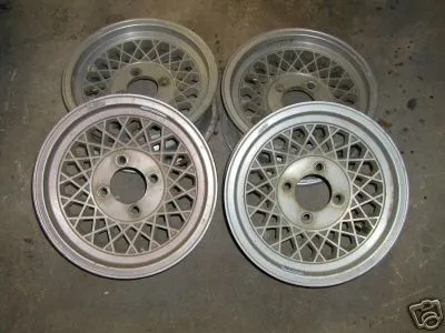

Good thing you didn't have any money...they won't fit
Our wheel pattern is 4 on 4.25 or 4 on 108 if you like millimeters.
The early Mustang he is referring to is real early and like Falcon and I think limited to the 6 cylinder versions
Later :spot:
PerceII is right, but it would be worth redrilling axles and rotors or using adapters just to have that kind of wheel on a II. Wheel Vintiques does make a similar wheel with a 4.25 inch bolt pattern in 15" for about 8-9 large bills.
I picked these up on ebay. They also are 4.5 inch bolt pattern but I am going to re-drill them to 4.25 and attach the II centercaps. They're 14 inch and look identical to the stock 13 inch lacy wheels.
