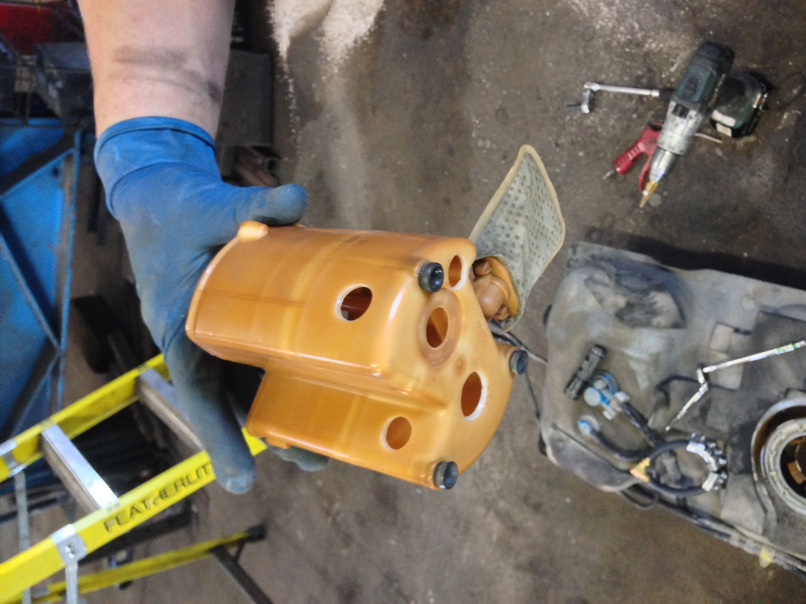

Yes I ended up drilling the basket last Friday while doing the PPRV delete. Couldn't be happier with the way things turned out. I know long have any hesitation between gears and my car pulls super hard all the time.
I ended up drilling 4 holes in the basket that were 7/8 and I made the existing hole 7/8 aswell. So a total of 5 7/8 holes in the basket.
If you ask me, this is a must have mod for a boosted 2v and all my buddies with cobras have also done pprv deletes.
Hope my info helps you out!
here is a pic of the basket

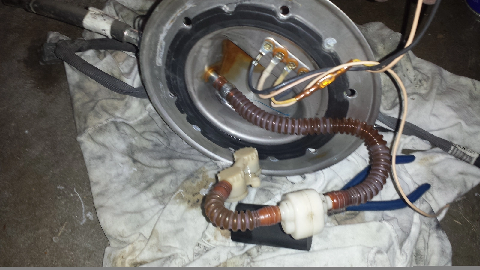

PPRV is a small valve that is built into the factory fuel lines inside the fuel pump module (or basket). PPRV delete removes the valve and replaces the crappy factory fuel lines inside the basket with regular rubber fuel lines.
Drilling the basket is drilling holes in the bottom or sides of the fuel pump module housing (basket), to allow more fuel to enter the basket faster and get to the fuel pump. All in all it keeps the fuel pump submerged in fuel when there is a high fuel consumption rate (i.e. a forced induction or high performance application).
Check out the above pic from Superstang. The large quarter sized holes were drilled into the housing. It was originally solid and hole free.

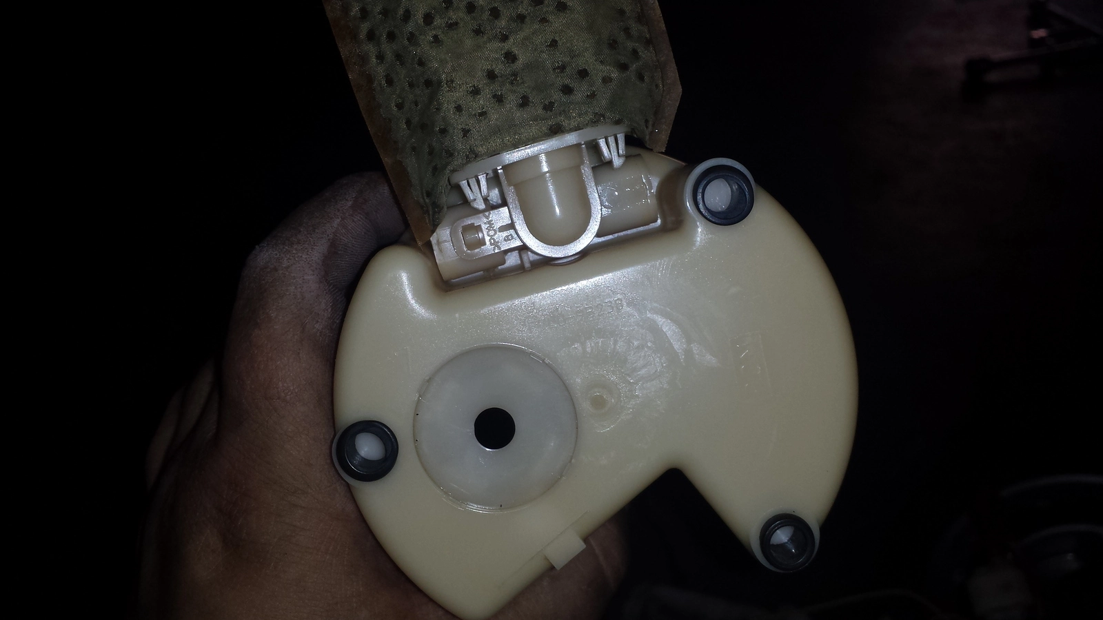

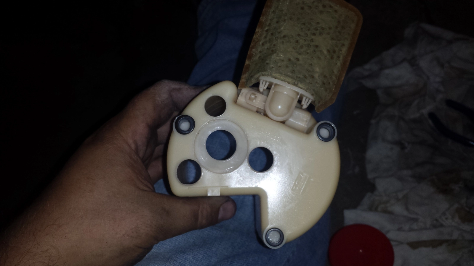

And the reason I drilled holes in the basket is so the pump doesnt run out of fuel. There is only a tiny hole the the pump basket from the factory which really doesnt cut it when putting out 400rwhp with a bigger pump.
I drilled the basket, replaced the oem line with the FPRV, and installed the KB FRPS disc.
