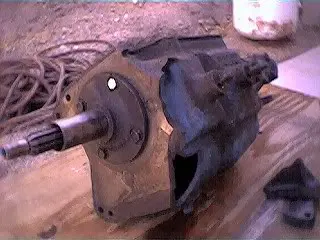

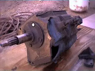

When I had my '65 notch, I was doing a speed run and the front U-joint fell apart. The problem was that it didn't come all the way off an spun REALLY out of balance at at about 90mph. It whipped so hard it broke two of the front mounting ears off the main case of my toploader and wrecked both the yoke and the driveshaft.
