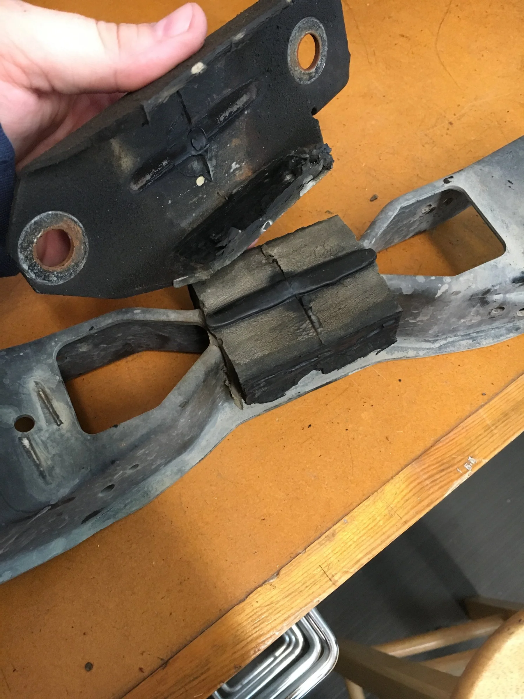

Found the problem. Just wanted to post a fix in case other people have the same issue. It was a bad transmission mount.
If that happened to me here I would be contacting the BAR(Bureau of Automotive Repair) and getting some money back from that "Auto Repair Shop".
