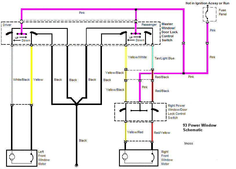

Power Window Wiring Diagrams
Diagrams courtesy of Tmoss & Stang&2birds
Fuse panel and circuit breaker layout
87-92 model cars power window wiring:
93 model cars power window wiring:
See the following website for some help from Tmoss (diagram designer) & Stang&2Birds (website host) for help on 88-95 wiring Mustang FAQ - Wiring & Engine Info Everyone should bookmark
